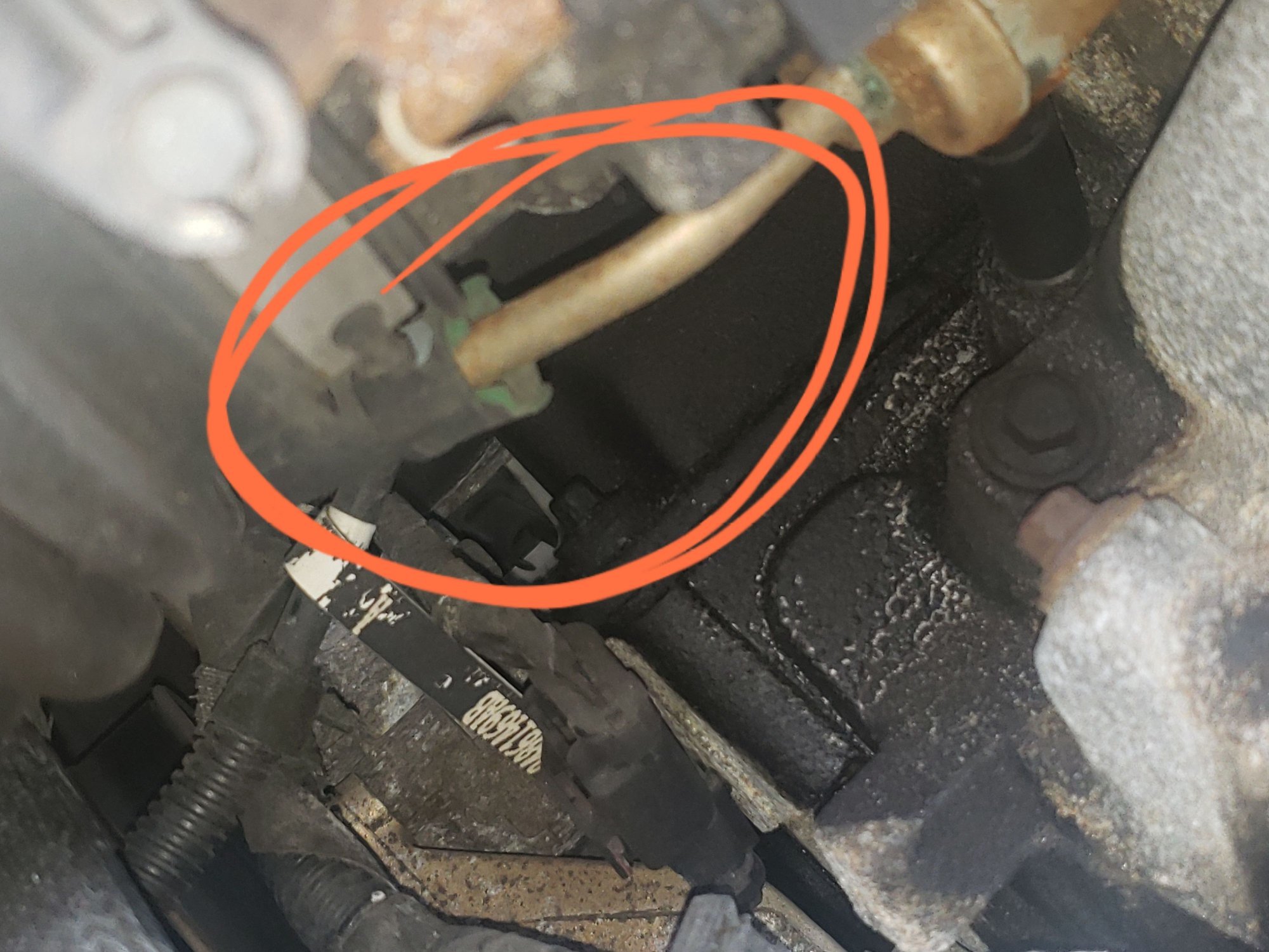

Originally Posted by georgef
That is not the fuel pressure test port, that is a pulsation damper, both my 2001 and 2003 have one. If there is a test port it will be on the left side of the engine under the throttle body air inlet.
Here is a picture of the test port on my 2001, the port was eliminated from later models, my 2003 doesn't have a test port.

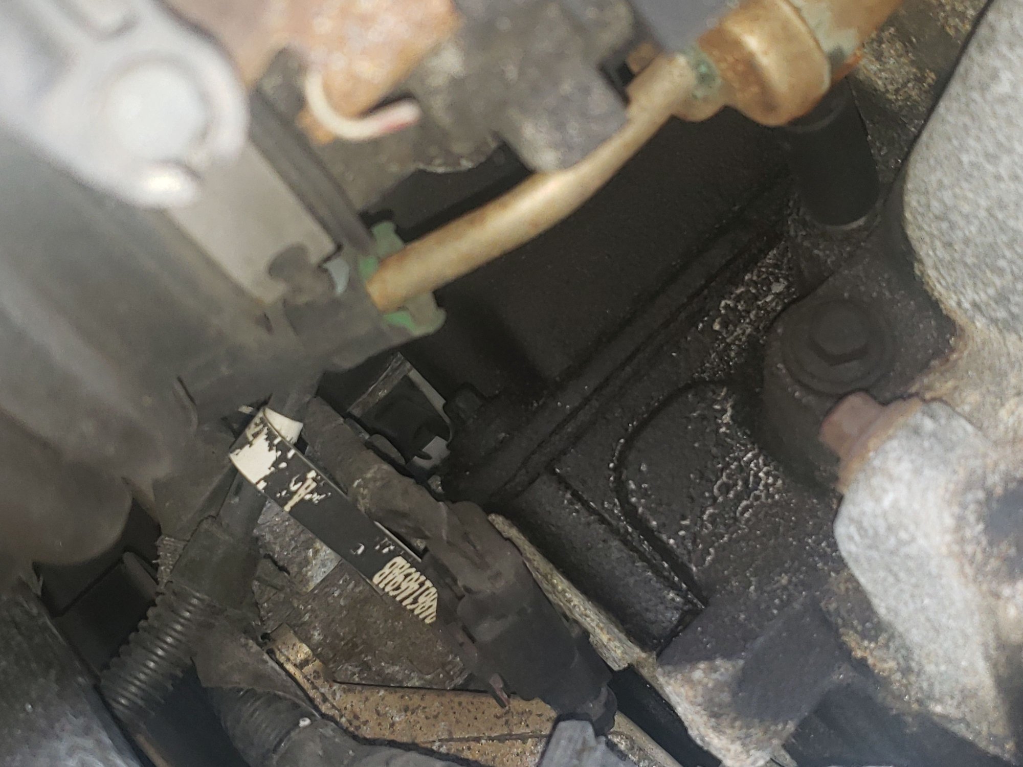

@GumbyRT i dont have a fuel pressure test port but i do have see a clip i can disconnect. Its where the test port would be in the image above you sent me. Is it safe to remove that there and crank the engine when it dies on me ? or is there a better location ? i cant seme to find a good video. ill attach a pic of what i mean.

You can disconnect the fuel line from there or at the filter, but be prepared for fuel to spray out of it. Even if the fuel pump is the reason it’s dying, there will be residual pressure.
If you’re going to check for fuel flow, have a container ready to catch the fuel. This will prevent gas from spilling everywhere and you can also do a quick volume test. The general rule for volume is 1 pint in 30 seconds, so if the pump primes the line for 2 seconds when the key is turned on, you can multiply whatever you catch by 15 for a glimpse of what the pump is delivering (example - 2 oz in 2 seconds times 15 = 30 oz - a good pump should be able to deliver much more than that, although it’s more accurate to run the pump for 5-10 seconds by jumping the fuel pump relay).
However, a pump can deliver good volume but low pressure, and vice versa. I recommend finding a kit like the one here (some auto stores may rent them) - https://www.harborfreight.com/mercha...kit-64939.html - it’s relatively cheap and will allow you to tee into the line so it can be tapped for a pressure gauge. If you do this, DON’T use the worm drive clamps - get clamps specifically for fuel injection - they are on the shelf at most auto parts stores.
That said, you should still be looking at the cam sensor and wiring, but I understand why you’re wanting to check the pump.
