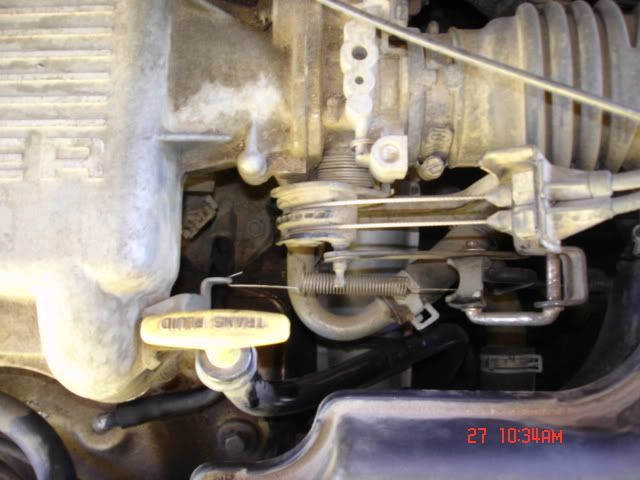

What causes oil to blow back into the resonator? PCV valve? And how do you get the PCV valve out anyway? It's at an angle in a very tight space. I found the longest 9/16th open end I had, but I can't budge it. Suggestions?

I know where it is, and it's a screw-in, and I bought a replacement yesterday. I just can't get to it. There's about 2 inches of clearance from above, absolutely no way to get to it from under the van. It takes a 9/16, but it's too long for a socket, and using a crescent, I can't get any leverage. It's at a 45 degree angle. There's no way to get a grip on it. Here's some pics, so y'all can see. Yeah, I know it's dirty lol!

How much oil in the resonator are we talking about? You could probably get on that with a crows foot socket attachment or a mid-deep socket on a swivel. Another thought is to try double wrenching by putting another wrench into the box-end of the wrench on the pcv to get you the leverage distance you need. Good Luck.

Even doing all that, I still can't get a grip on it because of the angle! It's angled toward the front of the van at a 45 degree angle. The way it's situated, to get a grip on it, I need to be able to get at it from the back (impossible) or have more than 2 inches of room there. Can't get a wrench on it the way the flat surfaces are situated. It must be the original part, I don't see how anyone could have gotten it into the position it's in with the rest of the engine built around it. Lord have mercy!

step 1: go to an ace hardware (or similar place for cheap tools)
step 2: buy 15mm wrench
step 3: heat up 15mm wrench
step 4: grab hammer
step 5: beat until desired angle is acheived
step 6: try new special tool
