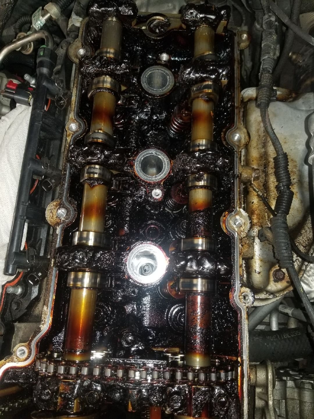

Is this about to die? Time to get a new one?

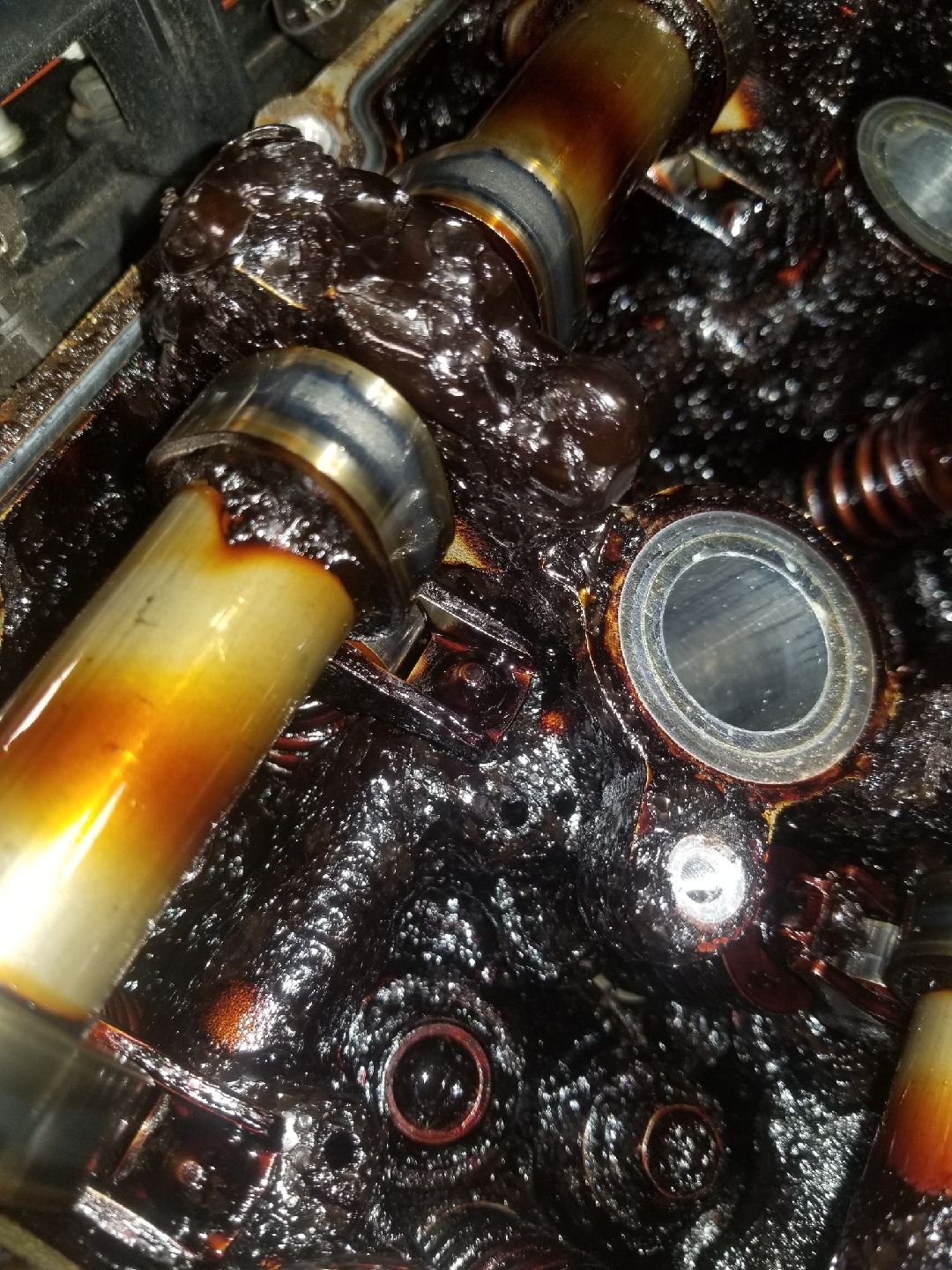

Holy sludge batman....whats the story on this?

2008 2.7 was leaking oil and had a injector acting up. Repair guy was changing the gaskets out and saw this, suggested I may need a new engine.

So, you never changed the oil or what?

I paid for regular oil changes, but this makes me wonder if they actually happened.

Well, I cant comment on if you need a new engine or not. But I can say, I will keep on doing my own oil changes...lol. You don't mention how many miles. If it runs good, button it back up and keep on driving it.

137k, so I guess this means new engine.

Any idea what brand oil they were putting in it?

Penz regular then switch to synthetic a few years ago.
Looks like the sludge problem is a defect:
https://en.wikipedia.org/wiki/Chrysler_LH_engine

Interesting....... So, maybe an external oil cooler, additional filter, to add some capacity (and better cooling) to the system might be in order?
