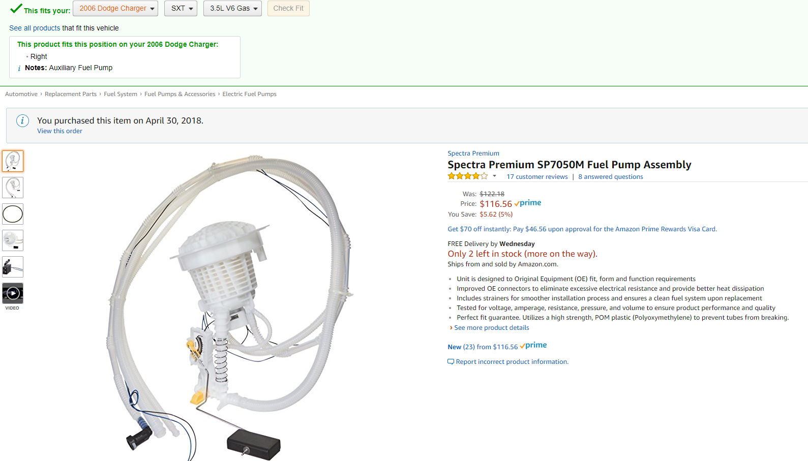

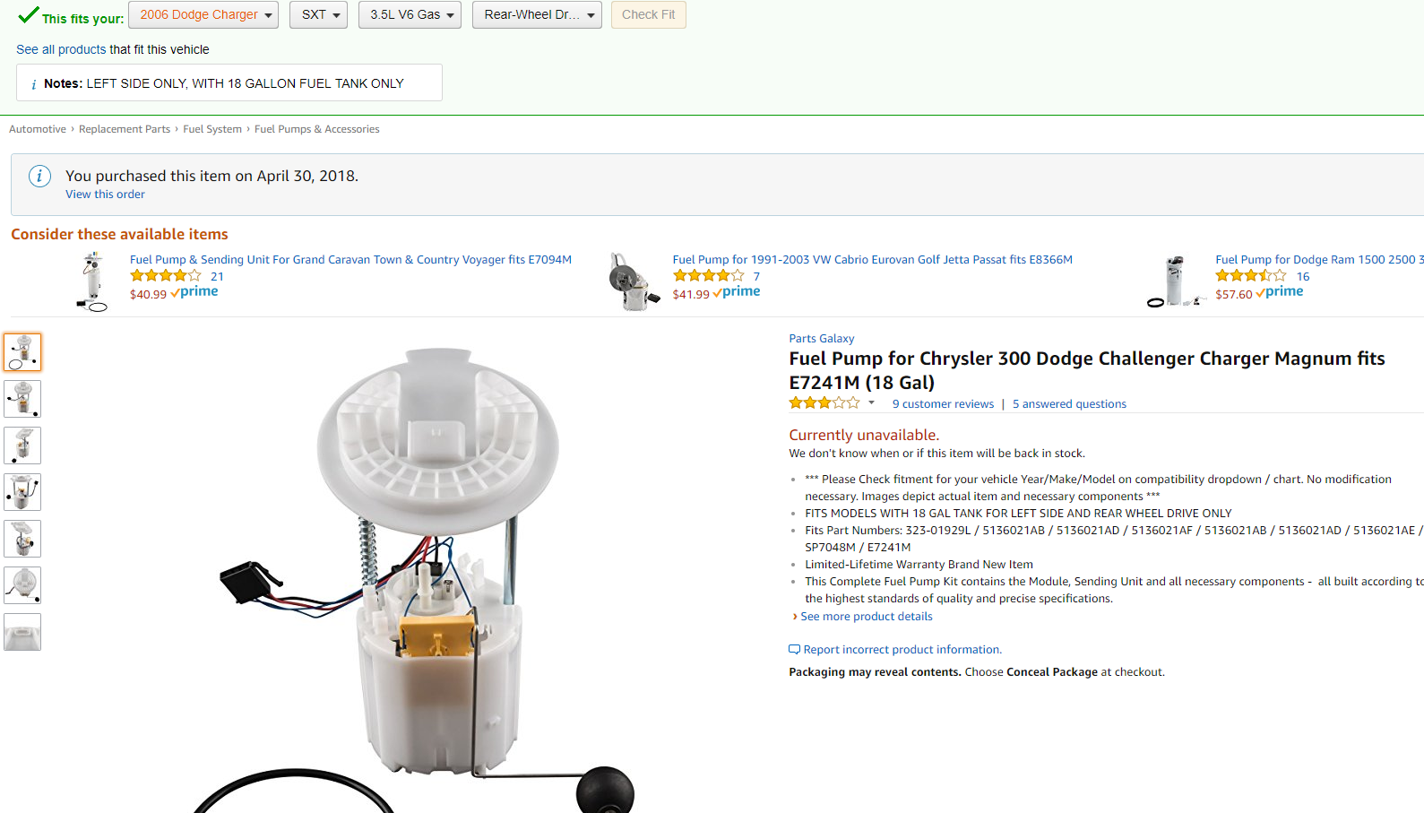

I bought this Fuel Pump in Amazon:
On April 30
After the installation, the check engine still on even after driving more than 100 miles to make sure the computer reset. I removed them again and reinstalled but still the same problem with the code. I also bought 2 clusters, and I ran a little with each one and yet, the codes still persist (P0463).
