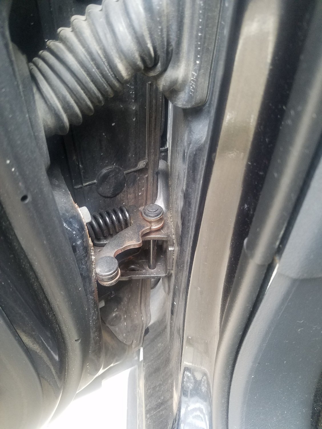

Here's mine....
Old Aug 21, 2019 | 03:17 PM
ChargerGurl's Avatar
ChargerGurl
Joined: Jan 2018
Posts: 7
From: Illinois
The problem happens when I move the door and the pin is supposed to move to the next space. It kind of pops and then the door goes lower. Forgive me please I don't know the right technical terms.

open the door....lift the outer end of the door up....if you see play in the pin...its worn and a bushing kit is needed. the op was referring to the welded bracket on the body separating from the body...if this is the case a re-enforcement must be welded to the body and the bracket welded to the re-enforcement.

Thanks so much! I've been thinking about this all day. I'll go do what you said right now. Sorry if I jumped on the wrong post with my issue, I didn't mean to. Have had trouble finding anything related to my issue and corresponding to Dodge Charger.
