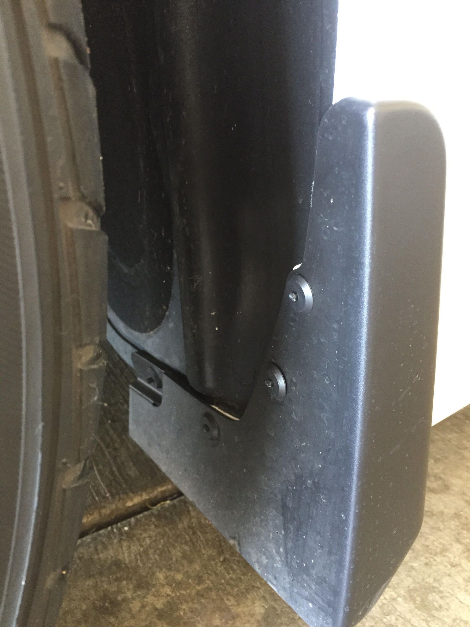

Default Splash Guard Install
Push lock pins purchased for install.
Front splash installed with plastic rivets.
Rear splash installed with purchased push-lock pins.
View of splash guards installed.
The splash guard install was relatively easy. The most time consuming part was removing and replacing the wheels. For both the front and rear splash guards there was some drilling required, but only once you have a push lock pin installed so lining everything up to look flush was simple. The Mopar splash guards come with these plastic rivets that you can see in the image of the front splash guard. I broke a few trying to get the front splash guard on and was unhappy with how securely it fastened the splash guard to the car, so I went down to my local O'Rileys and bought some push-lock pins that did the job. Paid $7 for 50 of them! You can see the part number in the image of the push-lock pins. I am really happy with how the splash guards look on the car and even happier with how they perform, no more stripes down the side of the car after hitting a bit of water!

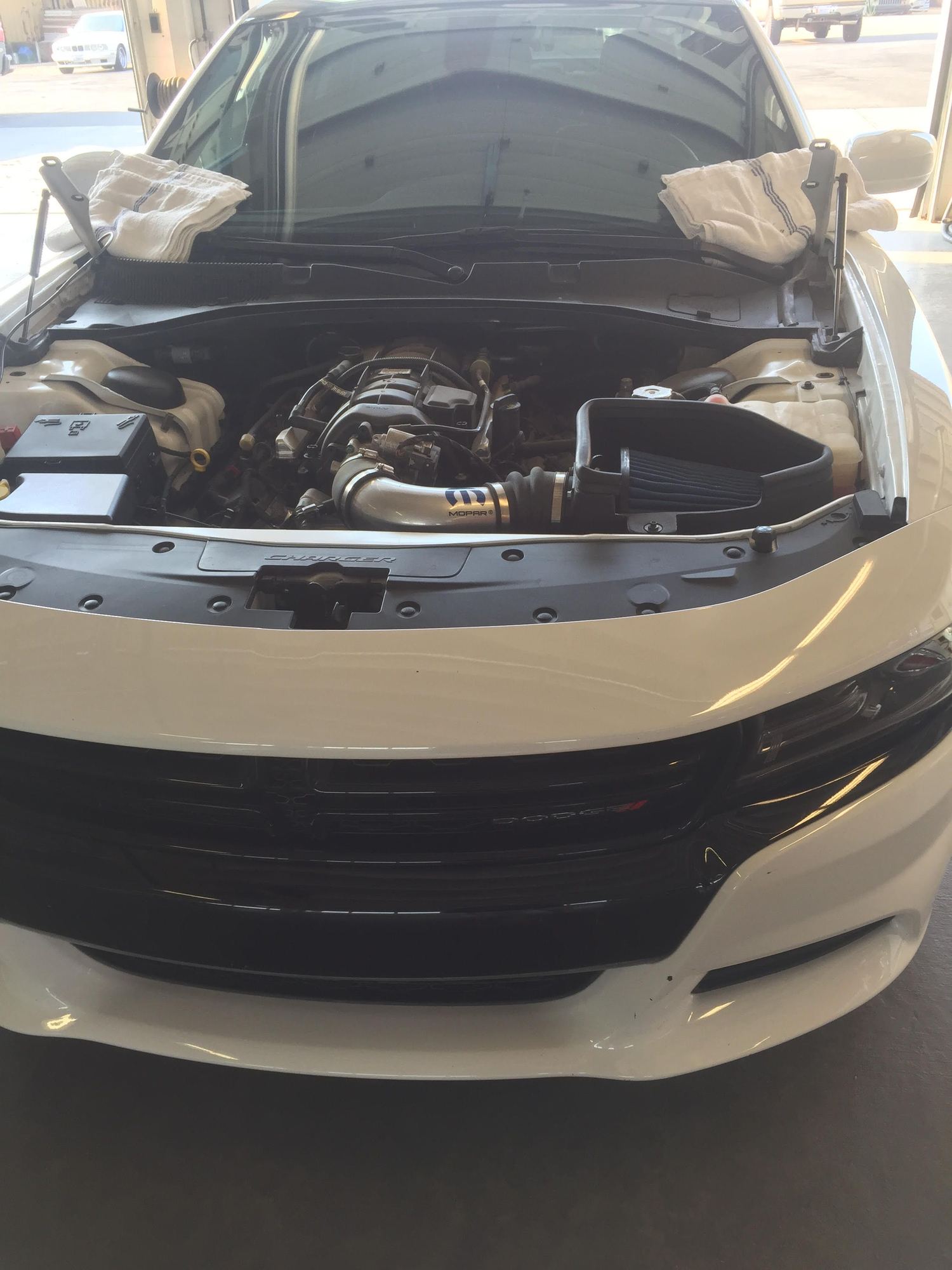

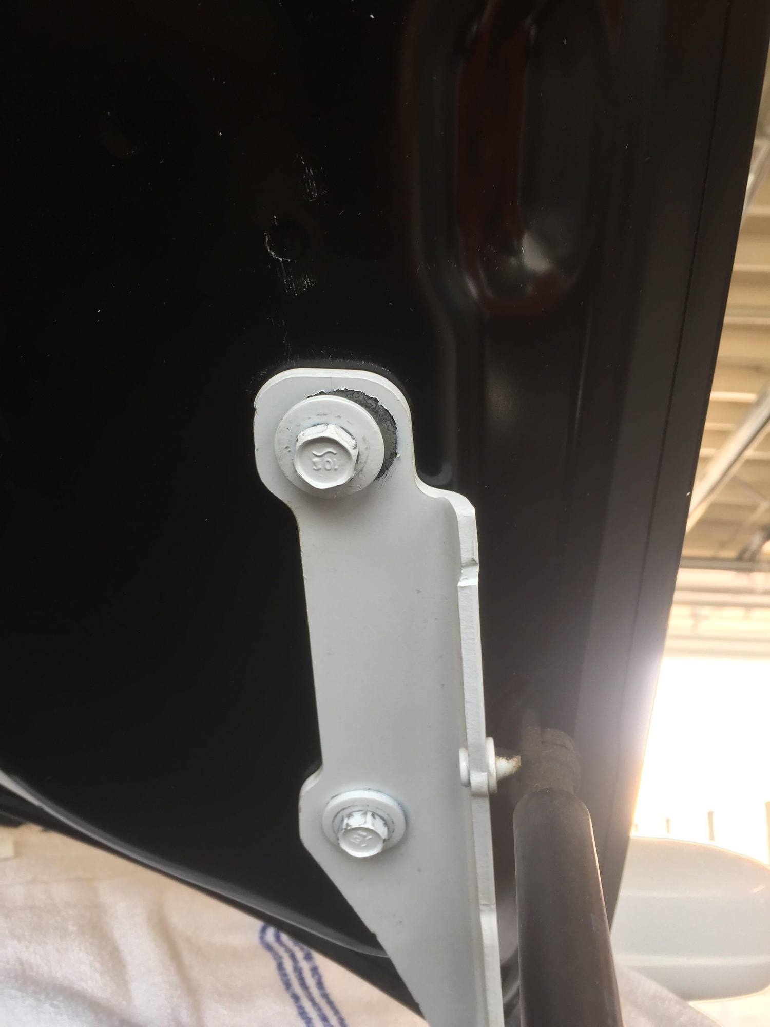

Default Hood Install
Removal
1) Remove insulation from old hood.
2) Disconnect washer hoses from washer nozzles.
3) Place towels or other insulating material on windshield in case of the hood coming down on windshield.
4) Using 13mm socket remove 4 bolts holding hood to strut brackets.
5) Carefully remove hood.
When you remove the hood you are going to "break paint" this will leave marks on the strut bracket for you to line the new hood up with.
Install
1) Place hood in place (having two people helps)
2) insert the 4 bolts that hold the hood to the strut bracket, do not tighten.
3) Align the washers with where you "broke paint" and tighten.
4) If this is your final install, put on other items such as bezels, insulation, and washer hoses and nozzles.
5) Carefully close hood looking for any pinch points.
6) Make adjustments to bracket location to ensure a good and even fitment.
This was not my final install so I do not have pictures of the hardware installation at this time.
Windshield Washer Hoses
Hood Removed with towels in place
Showing the washer and the paint ring
