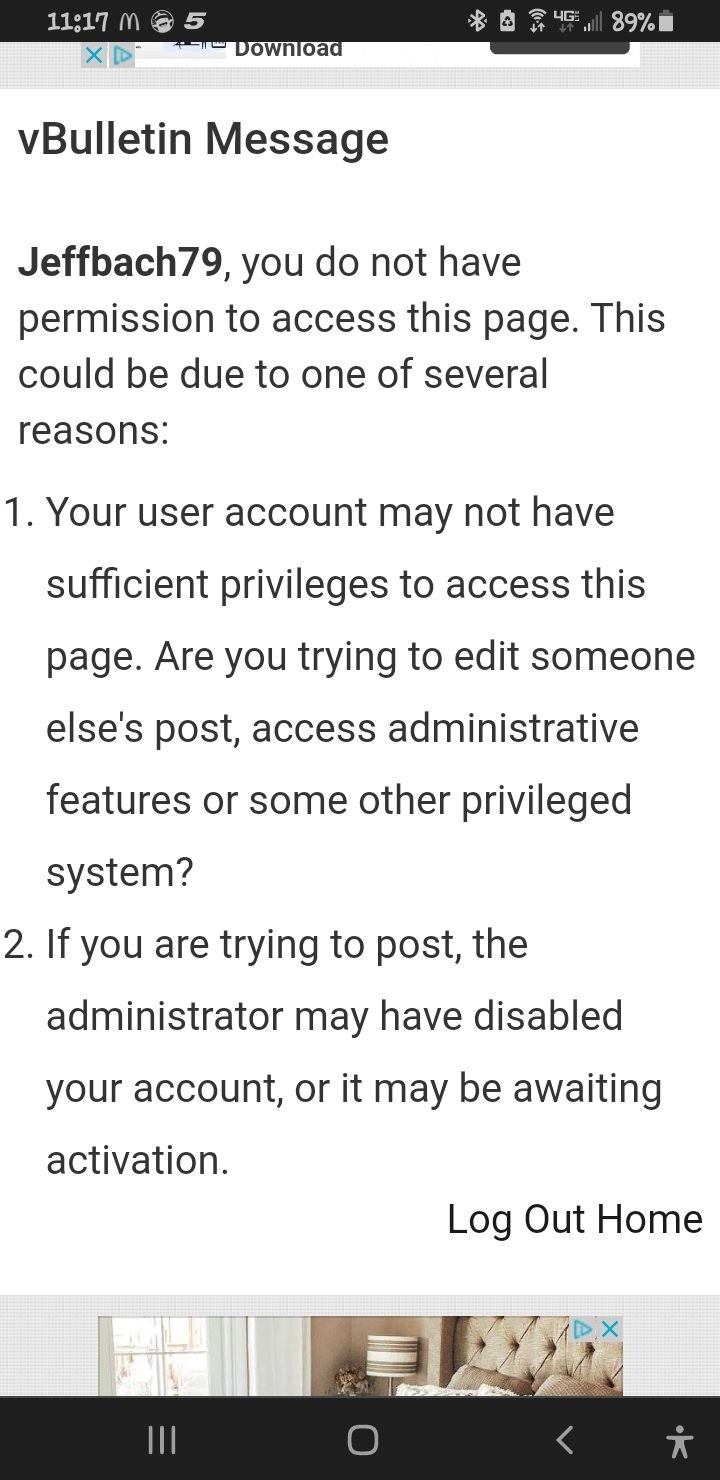

Click on her Username, which will take you to her profile. Right below her username, will be the "send message" link, with a dropdown arrow. Click the arrow, and select "send private message".
I've tried doing this, but I keep getting this screen:
Old Oct 24, 2021 | 11:32 AM
Posts: 87,482
Try it now.
