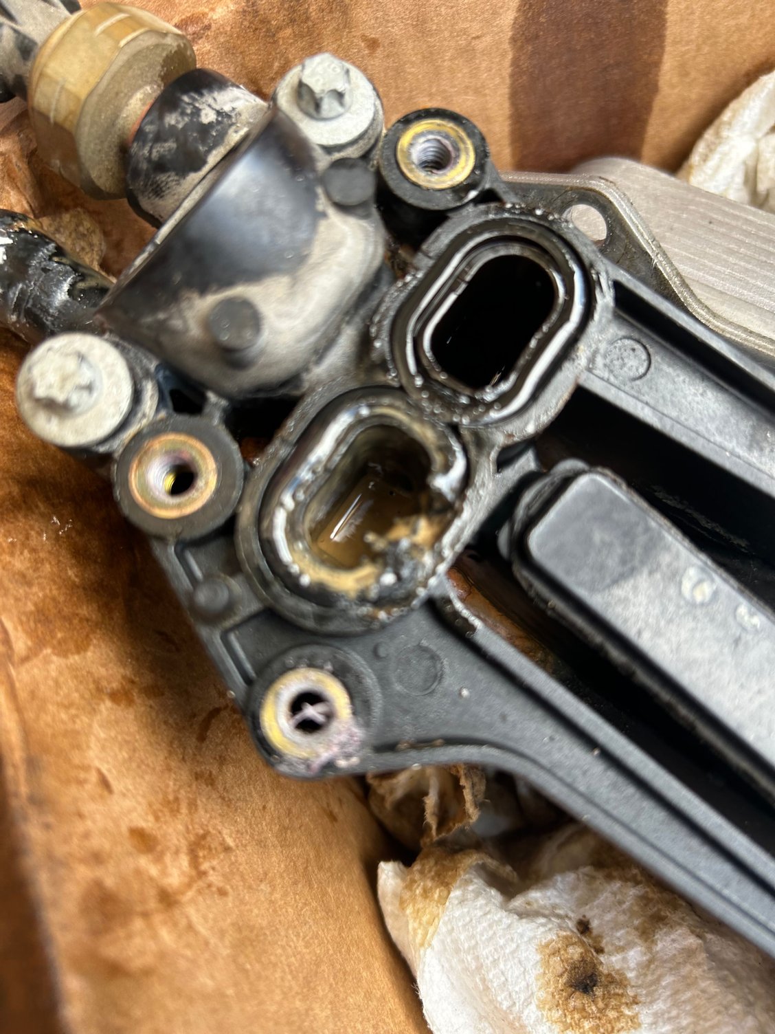

I bought a Charger 2017 with 3.6 pentastar engine and i notic oil in water does some one have this problem
Had the same issue (2017 Jeep Grand Cherokee 3.6L - 98k miles). Can confirm that the issue is a crack in the oil cooler housing/ failed seals. My symptoms were milky, brown liquid in coolant system. Low oil, but no water in the oil.
Replaced with the aluminum version “Dorman - OE Solutions Engine Oil Filter Adapter 926-959”.
Disclaimer I am not a mechanic and do not know the safety and mechanical concerns of doing the following…To cleanse the oil from the coolant system I ran diesel through and drained twice. Then water four times.

Generally the oil cooler is the culprit when oil is mixing with coolant. When you have 60psi oil and 15 psi coolant the oil can push into the cooling system. These coolers are also known for external oil and coolant leaks on these engines. 200k miles on the wife's jeep and this will be the 3rd one . Hope this helps
Some rough luck, my Durango is at 160k on the factory one, knock on wood, just replaced the radiator so I suppose it would happen now.
