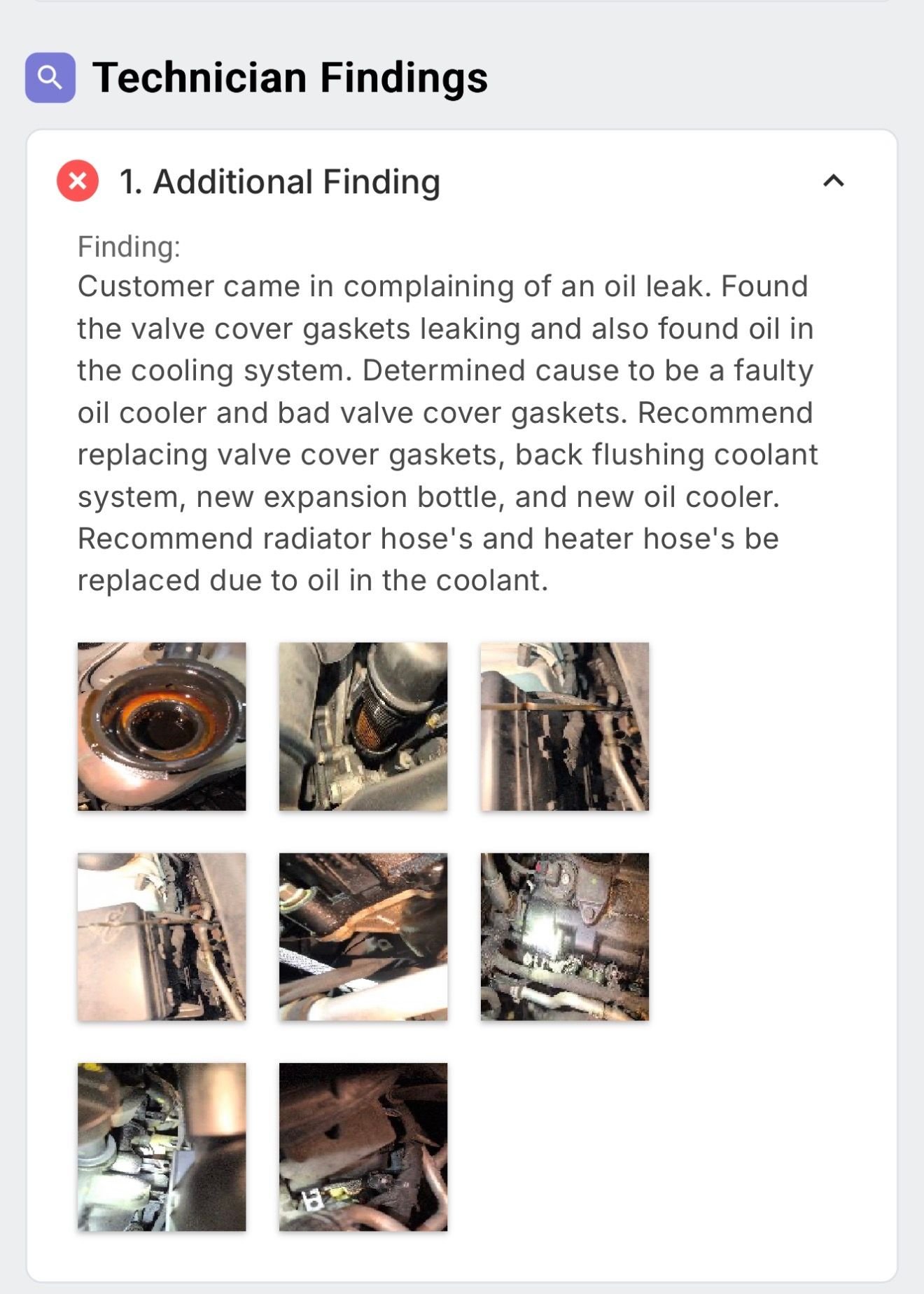

So I took my car to get an oil change and the dealership informed me that the car may have an oil leak somewhere. I had them diagnose the car and they then informed me it’s oil in the coolant reservoir. The car isn’t running hot, there’s no black or grey smoke coming from the exhaust or anywhere. They told me they can’t help finish the diagnose because they don’t have anyone certified who knows about dodges that well. My question is, is this a blown head gasket possibly or is this something small that can be fixed?

I believe there is an oil cooler there, that can develop a leak.

Looks like it goes above the oil filter, and is indeed plumbed into the cooling system.

unfortunately this wasn't a used dealer or buy here pay here. I bought my far from an actual dealer called Boniface here in Florida. I have since taken it to a mechanic shop and they have found the issue and is currently fixing it. I only could tell you what the dealership informed me and put on the paperwork.

yes I found that odd and made me uneasy. So far the shop discovered this and is currently working on. I really appreciate you guys feedback.

Hey look! A tech that has his head screwed on tight.
Go with his suggestions.

That's a pretty good system they have there. I don't disagree with the technician's recommendations either.
