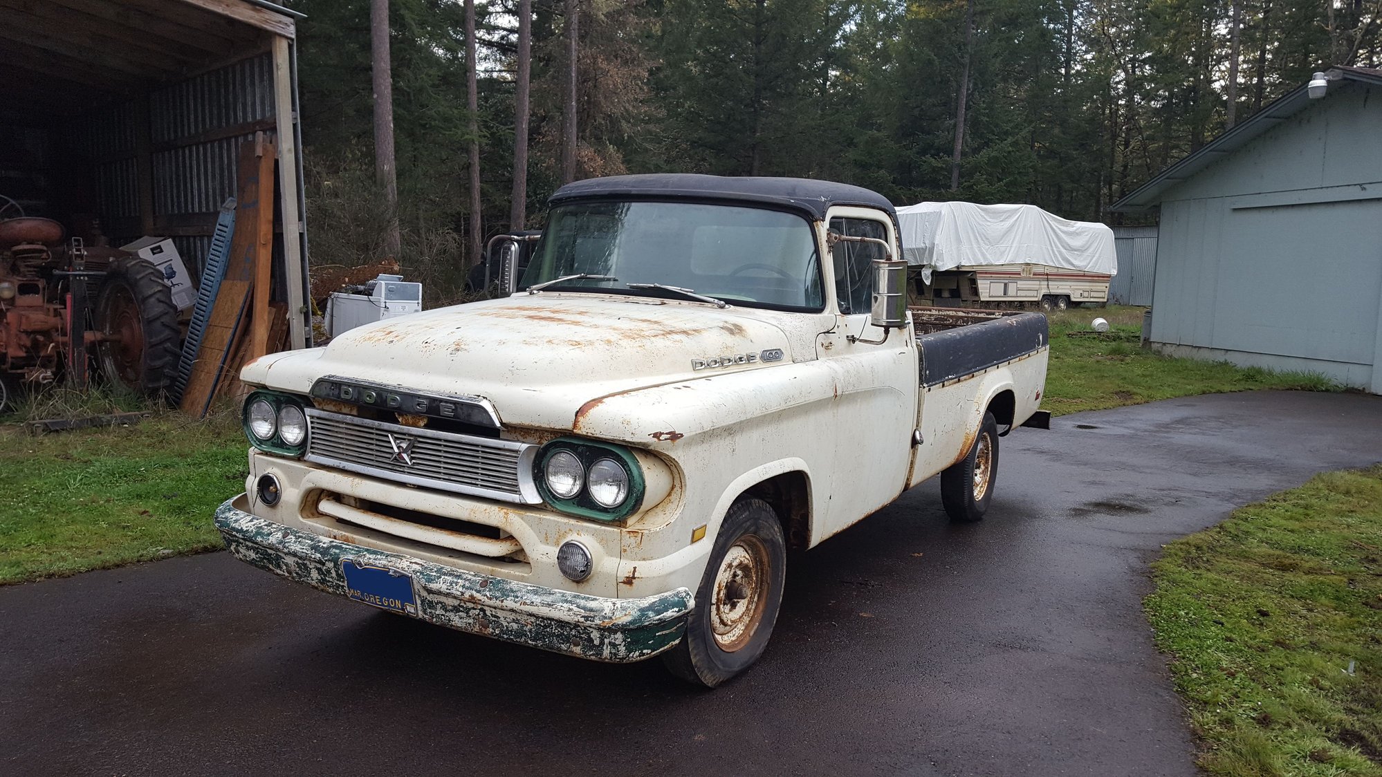

Fresh out from under the tree.

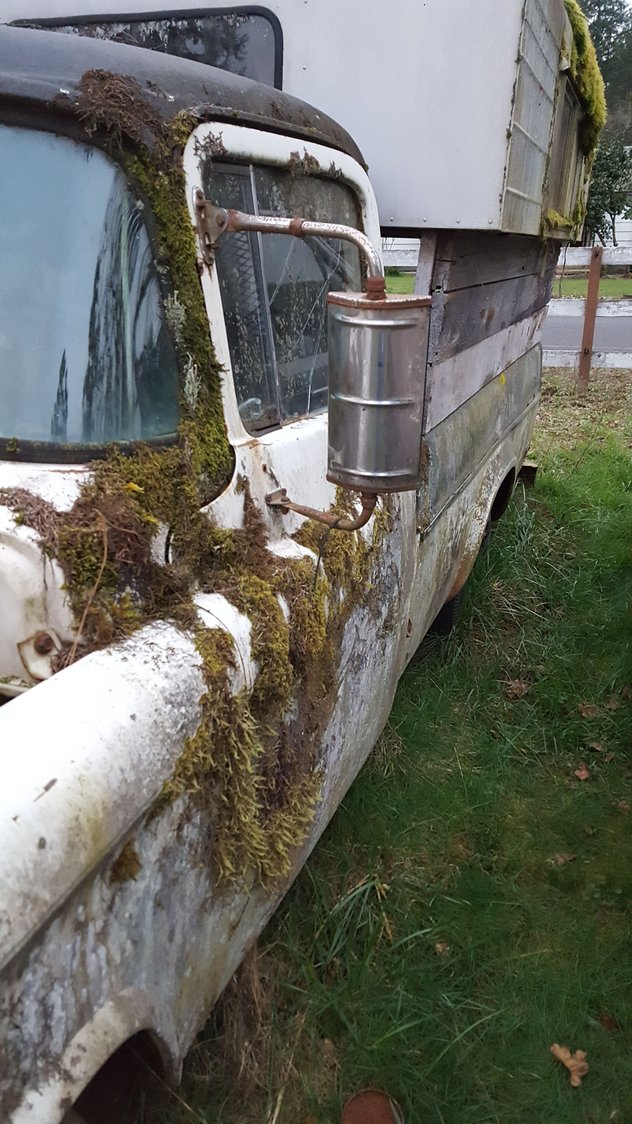

Moss grows well here.
Engine bay.
After some quality time with the pressure washer.

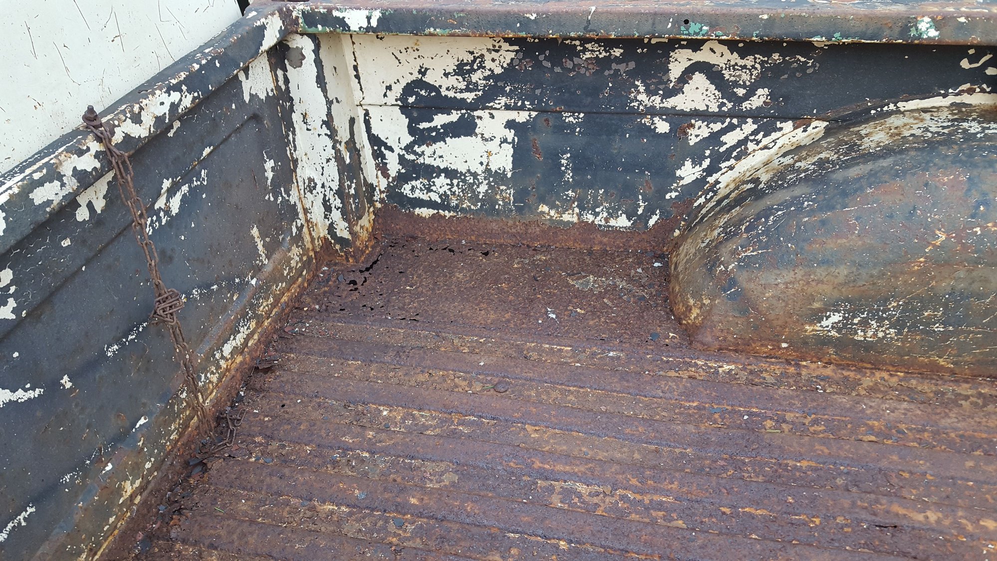

Condition of the bed.

That truck is definitely worth saving. I can rattle on for pages about what you need to do. I've brought many Mopars, some worse than your truck, back over the years. I'll stick with brakes right now. It sounds like your master cylinder is toast and may not be worth rebuilding. Chrysler used that master cylinder with manual brakes on its cars from 1956 to '61. Some '61 cars had different brake light switches.
On your wheel cylinders, here's a tip to get the front ones apart. They are closed ended. Once you get a good master cylinder on it, remove the shoes and brake hardware. Place a C clamp on the upper wheel cylinder to hold it together. Leave the bottom one open. With both feet, press the snot out of the brake pedal. This should blow the wheel cylinder apart. Now remove the steel line between the two cylinders and remove the C clamp. Plug the hole from the line with a steel plug and repeat. You may be able to hone them out and rebuild them. A rebuild kit will service one wheel. On the back, you have the dual piston units like most cars and trucks. The front, is two single piston cylinders.
By the way, your camper shell is for a different bed size. It's been modified to work on your truck. I've seen that done before. Your truck is more solid than I expected. Your rear drums will be a booger to get off. There is a specific tool to remove them. It may be available for rent. I know some tricks that will work on a running and driving vehicle, but they won't work on yours. I think my puller cost me around $100 back around 1980 or so.
This truck will be a long term project but I think you'll be happy with the end result.
