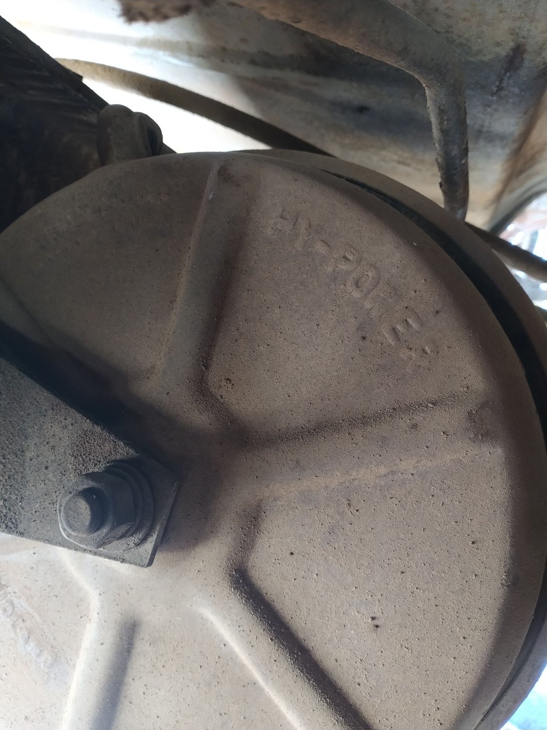

I completed the installation of the master brake cylinder and need to bleed the brakes. But just pumping once seems to be pretty good at the moment.
Now I'm wondering about whether I need to rebuild the brake booster. I guess I need to determine that after driving a bit. While it was sitting for months my clutch master cylinder became empty so I'll need to bleed that to have any clutch.
Anyone know a source in northern California for a rebuild kit on the booster? Or a shop where I can get it done? I prefer to learn how myself. If anyone can rebuild it then there must be a rebuild kit available.
It's a Midland Hy-Power. Anyone know if the D500 is the same as the D300 booster? Because maybe Rockauto has them.

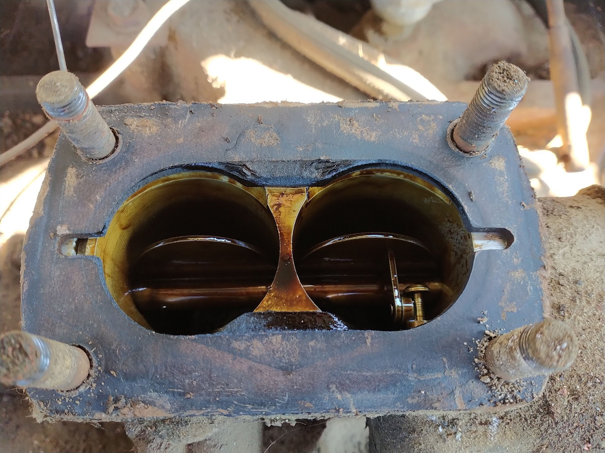

Rebuilding the carburetor which is the Carter BBD model. It has a mechanical governor at the base of it and was not hooked up. It was not capped off either. Seems to me that would create a vacuum leak, right?
Obviously, it was designed to use the governor but not sure if I can rebuild it. So can I just cap off the tube and ignore it without something bad happening?
It's possible that the metal screen was clogged up. And the throttle plates are stuck in the open position but after cleaning it might be possible to close them.
