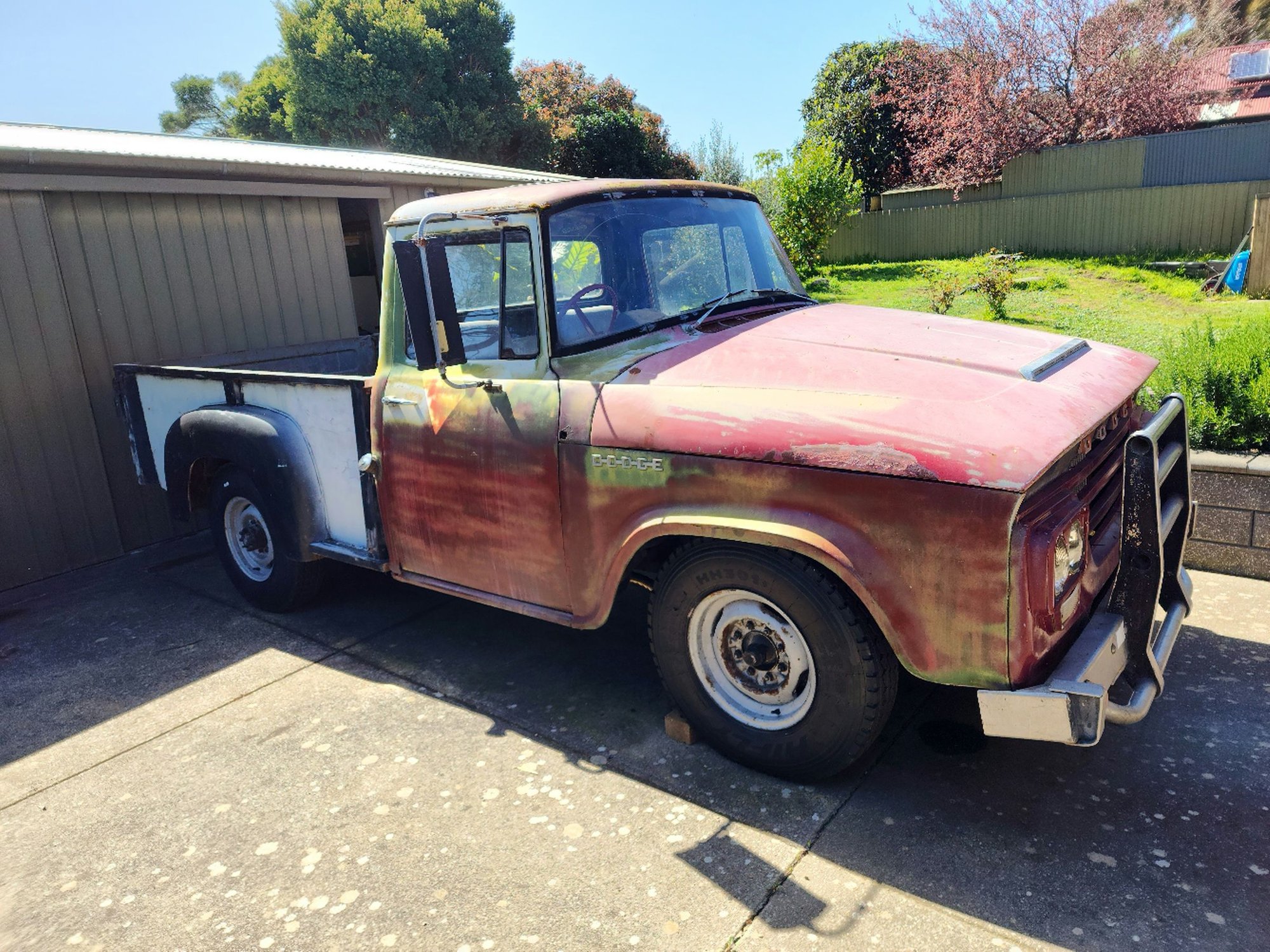

Hey
I'm located in south oz

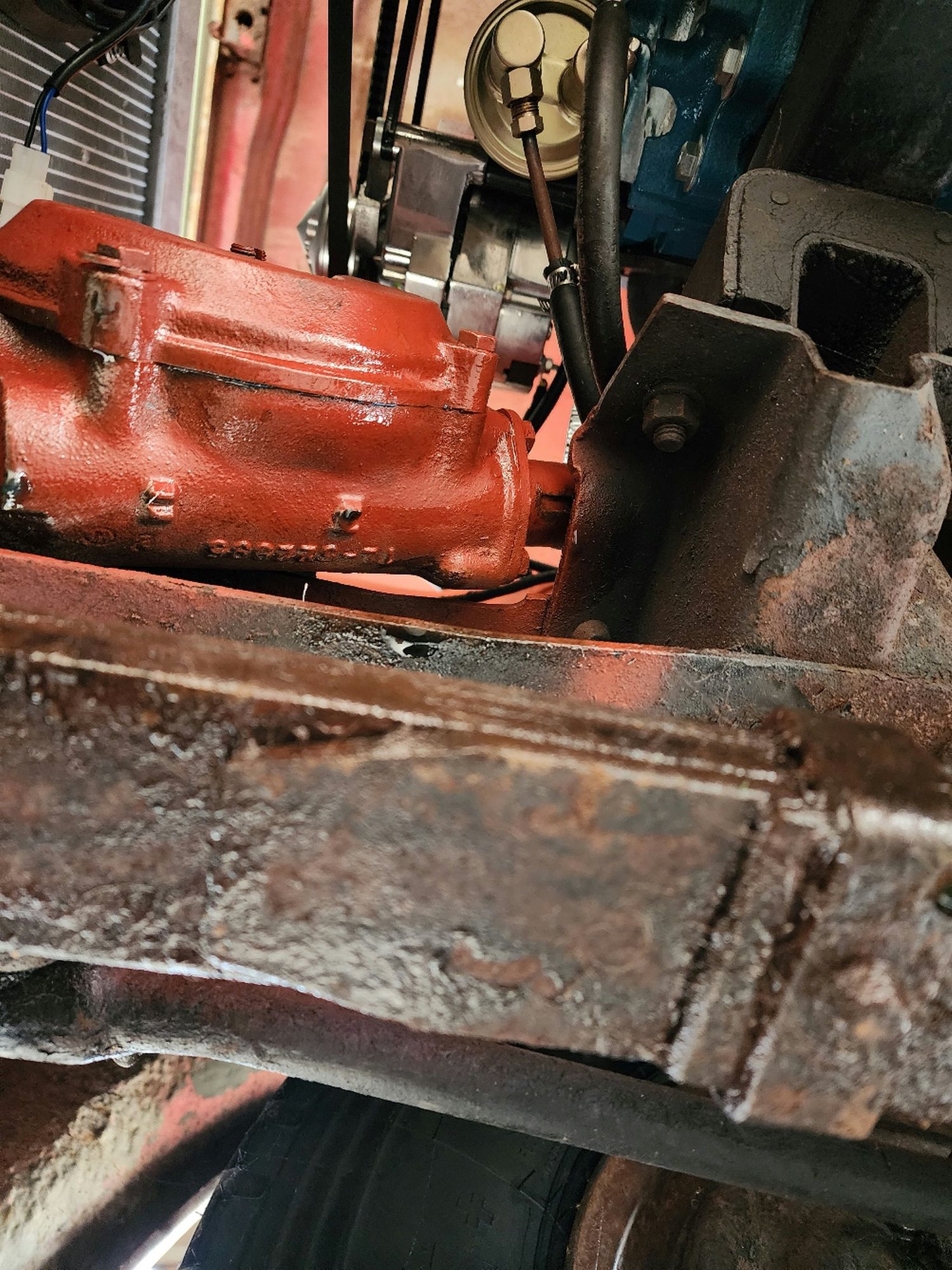

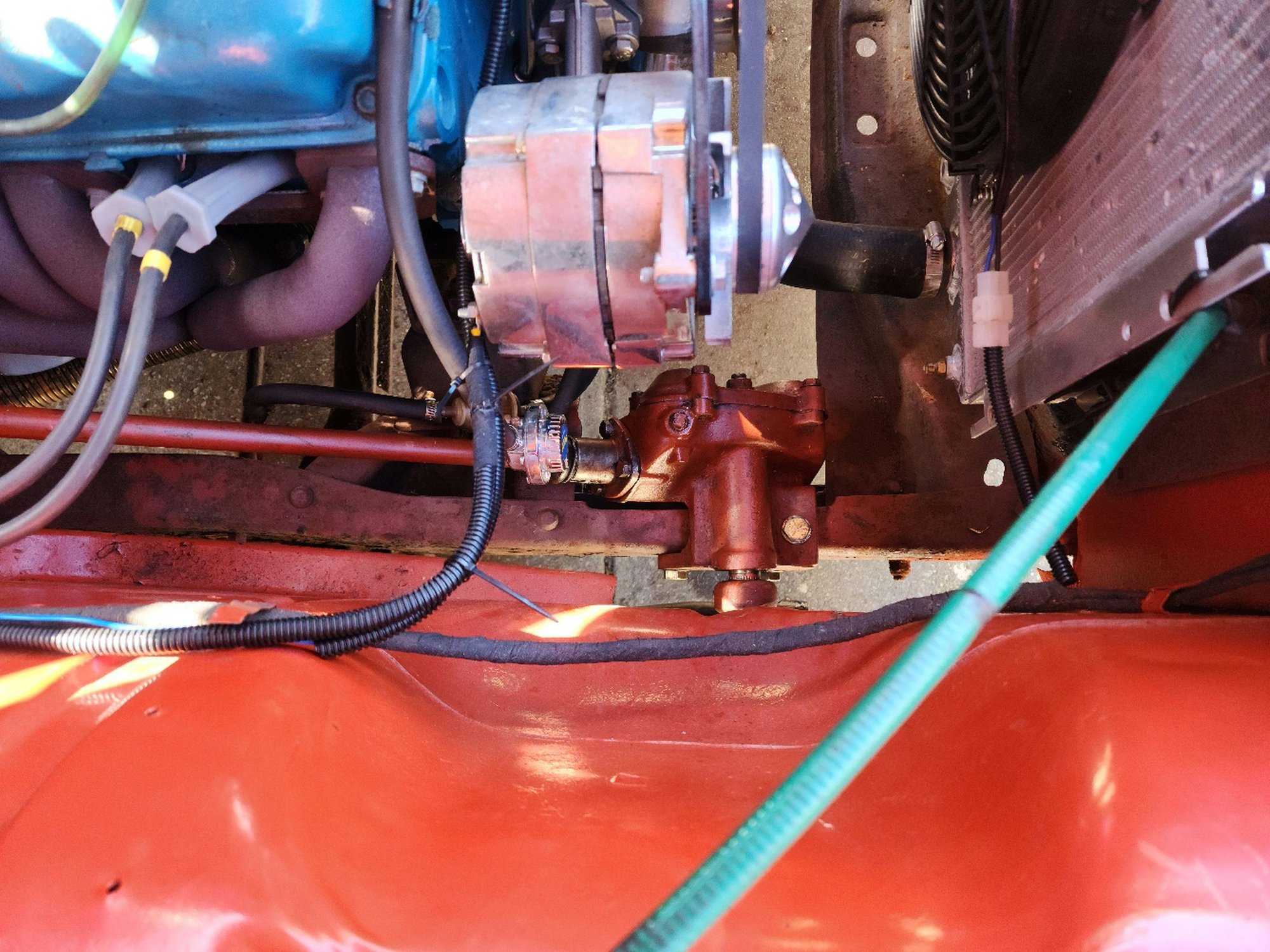

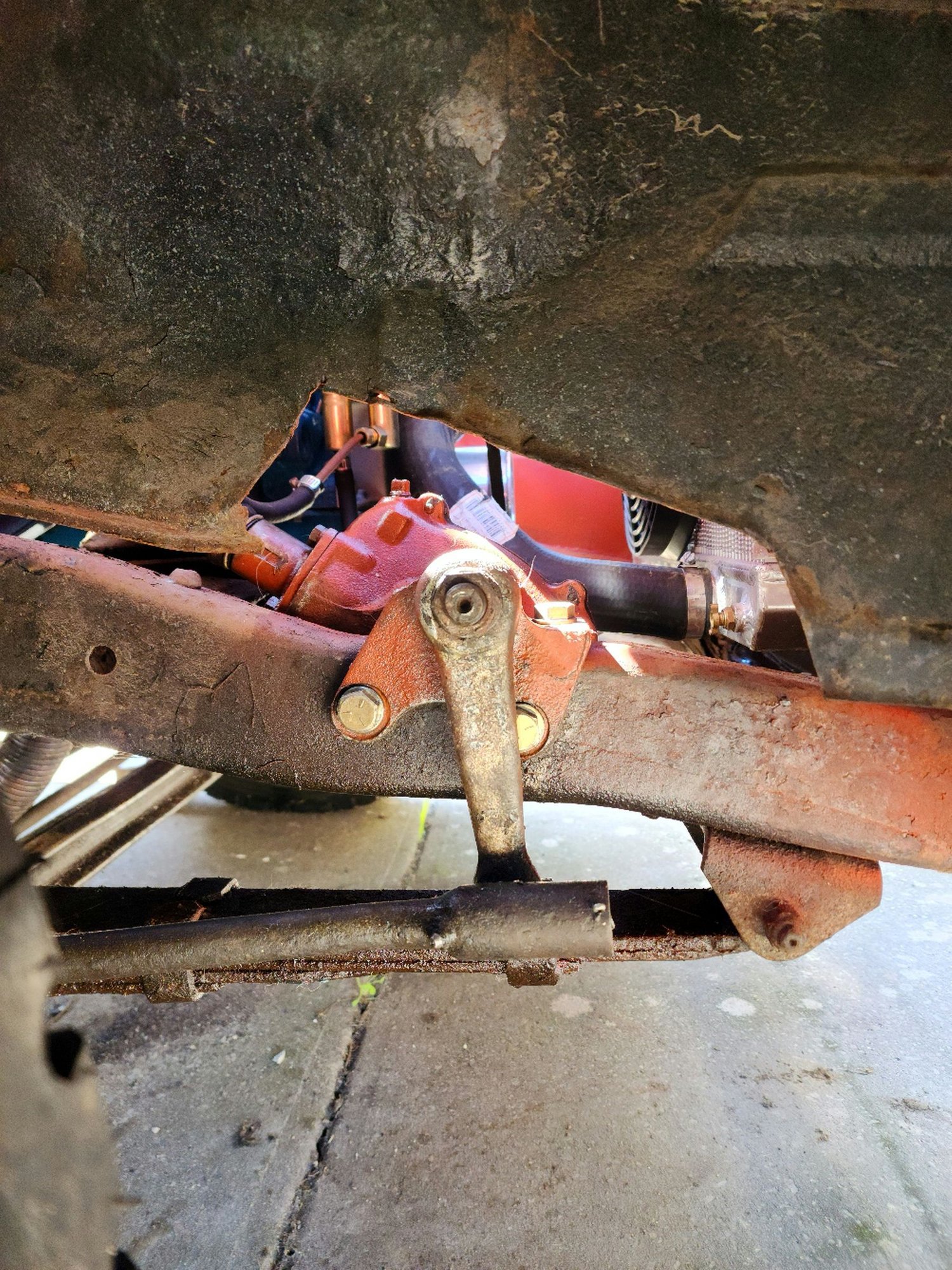

Someone had already started fiddling with the truck before I got it. They've dropped a 1977 la318 into it but I believe originally it would have had the 225 slant 6.
Its one of the right hand drive oz built trucks.
unsure if the steering box is standard as it looks like the guard has been trimmed a bit.
Cheers
Reply 0
Sep 5, 2023 | 09:23 AM
Okay, I have something to start with now. It looks like Chrysler used the "Power House" trucks in Oz when they went with the "Sweptline" in the U.S. Usually the more complex mechanical parts are updated when older body dies are used. I'll hit my older Hollander books first and see if I can find a listing for RHD as the post office uses a lot of RHD to deliver mail in rural areas. The Australian post may use LHD vehicles for that in Oz.

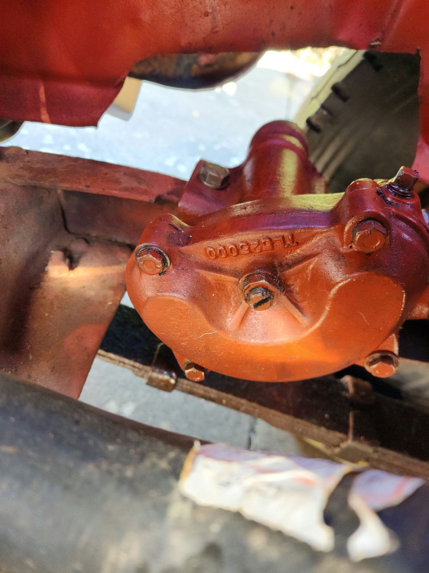

although ross isn't actually stamped anywhere i believe its ross TL steering gear. Looks pretty similar to some stuff used in ****** Jeeps of the same era.
2 numbers cast on the case TL-522995 and TL525000
worm gear stamped TL523081
and the lever gear TL524979

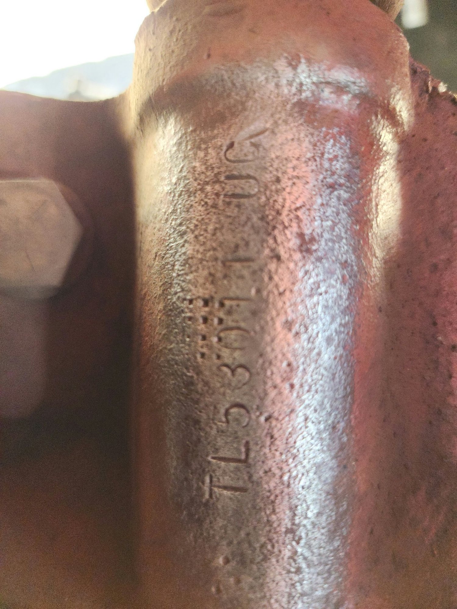

I did however find another number stamped on the side of the box. Believe its TL53011 UC
