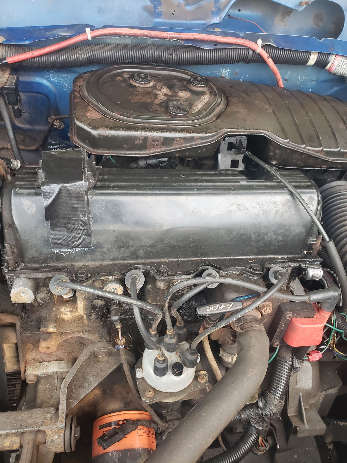

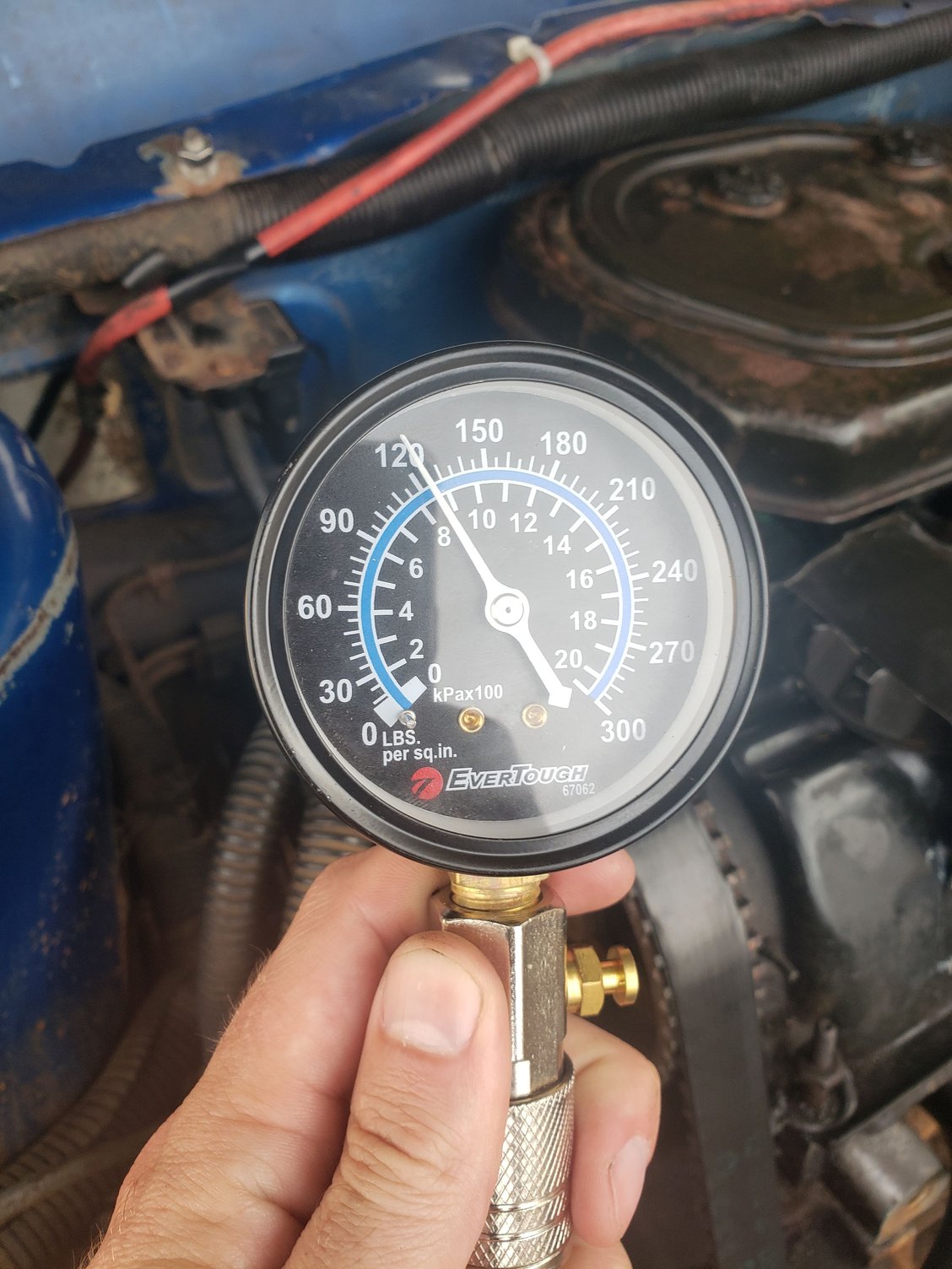

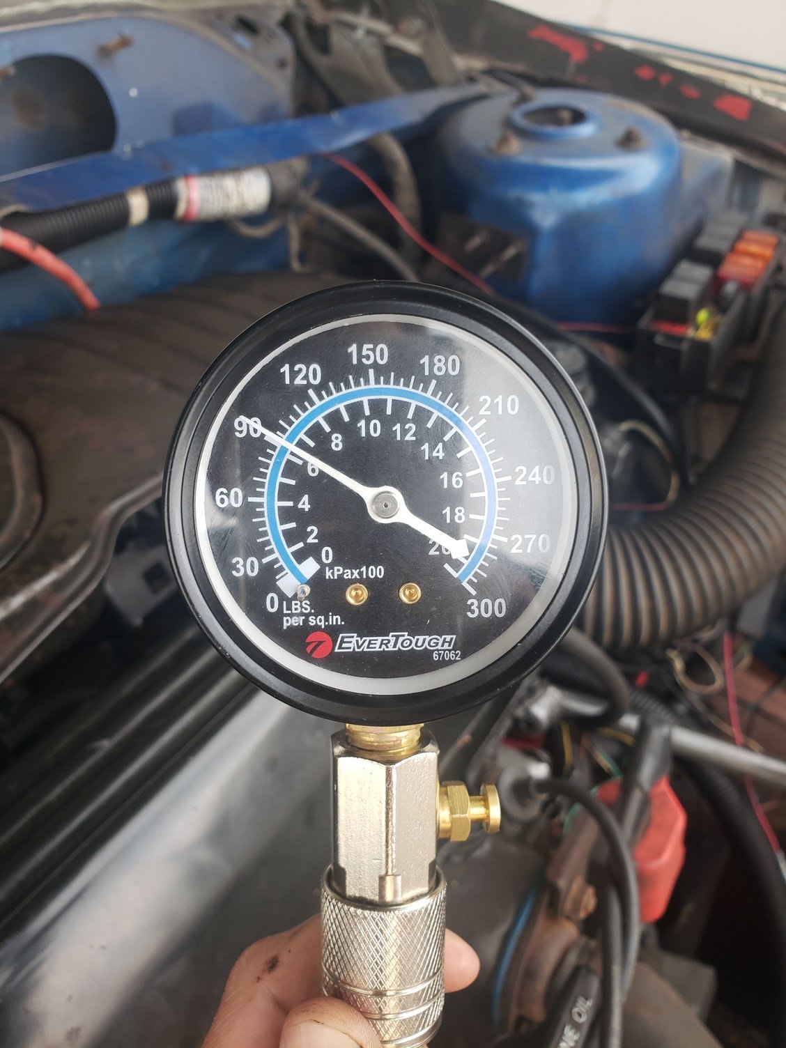

Okay, so I just did the compression test, I'm struggling to find a cylinder diagram, so I'll just add pictures. Looking at it from the left side, the 1st 2 cylinders read 120, the next 2 read just at and just below 90. Is this normal?
Old Aug 24, 2023 | 08:31 PM
ol' grouch's Avatar
ol' grouch
Joined: May 2019
Posts: 5,174
Likes: 724
From: S.W. Indiana
That's not good. For cylinders to be mismatched by a little is normal. With the odd vacuum readings, I think you may have a problem with cylinders #3 and 4. (Passenger to drivers side is 1,2,3,4) I suspect a blown head gasket. You have probably one of the easiest modern engines to repair a blown gasket, but the head will need to come off. Before we condemn it, pop the cat off and see what happens.
