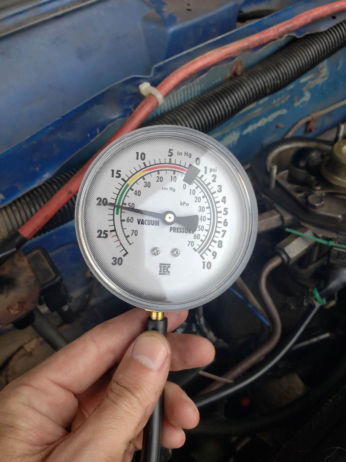

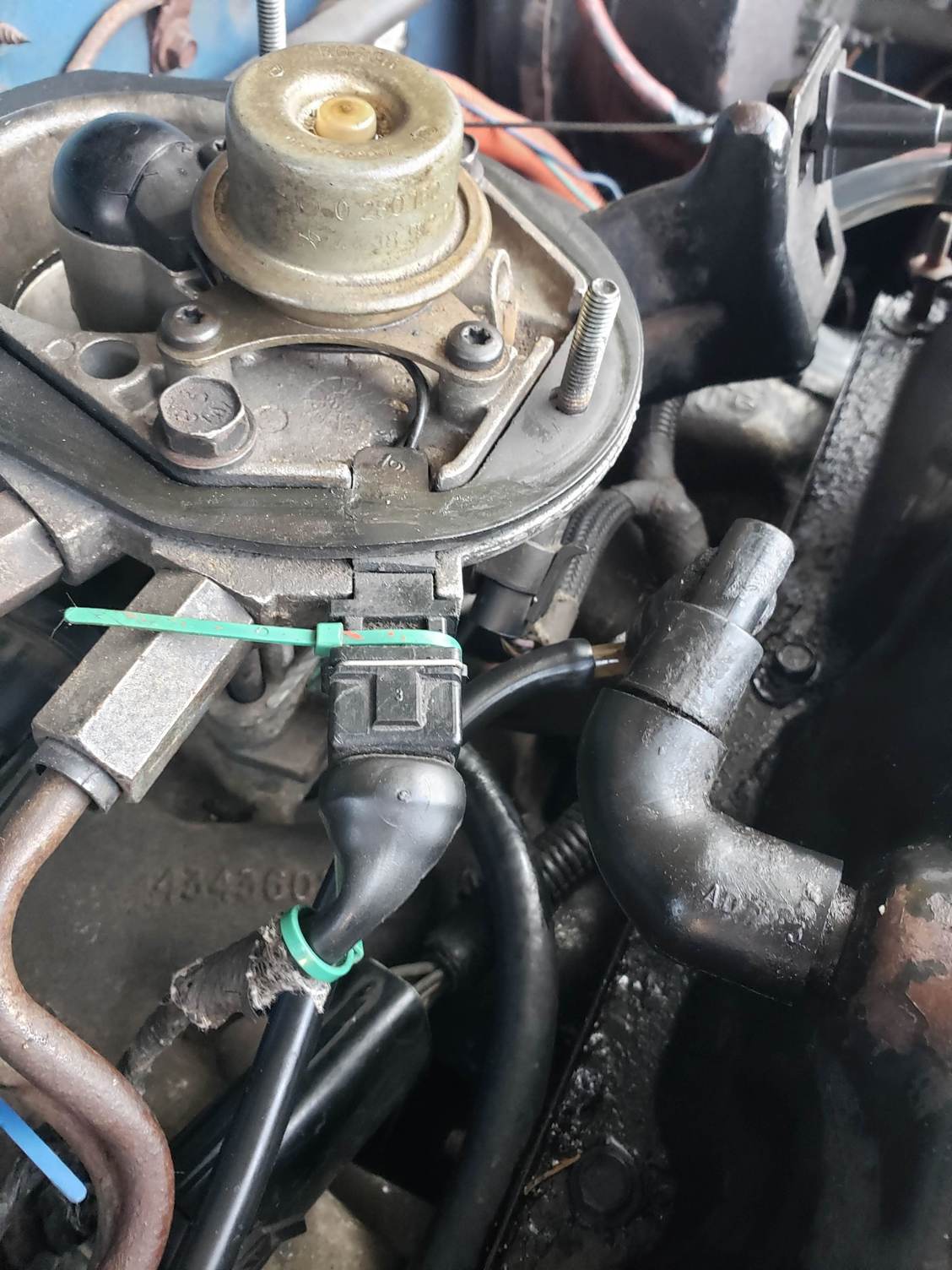

Exhaust is stock, the Cat is still there as well. New o2 sensor too. No mice, I've been all around the car, and I don't see any evidence of them. Where would I check for vacuum on this car? Is there like a port I would plug a vacuum gauge on to? (I know my local AutoZone has vacuum gauges I can get, but I've never used one)

I can almost bet your converter has collapsed inside. Look for a vacuum line around the throttle body. Look for a rubber cap on something like the manifold. I used to rally cross an '89 Omni and ran a vacuum gauge on it all the time to see what power reserve I had. If you can't find a blocked off port, get some vacuum line and vacuum adapters (little pointy splices) and put the gauge inline. You always want a vacuum gauge handy as it tells you how healthy the engine is.

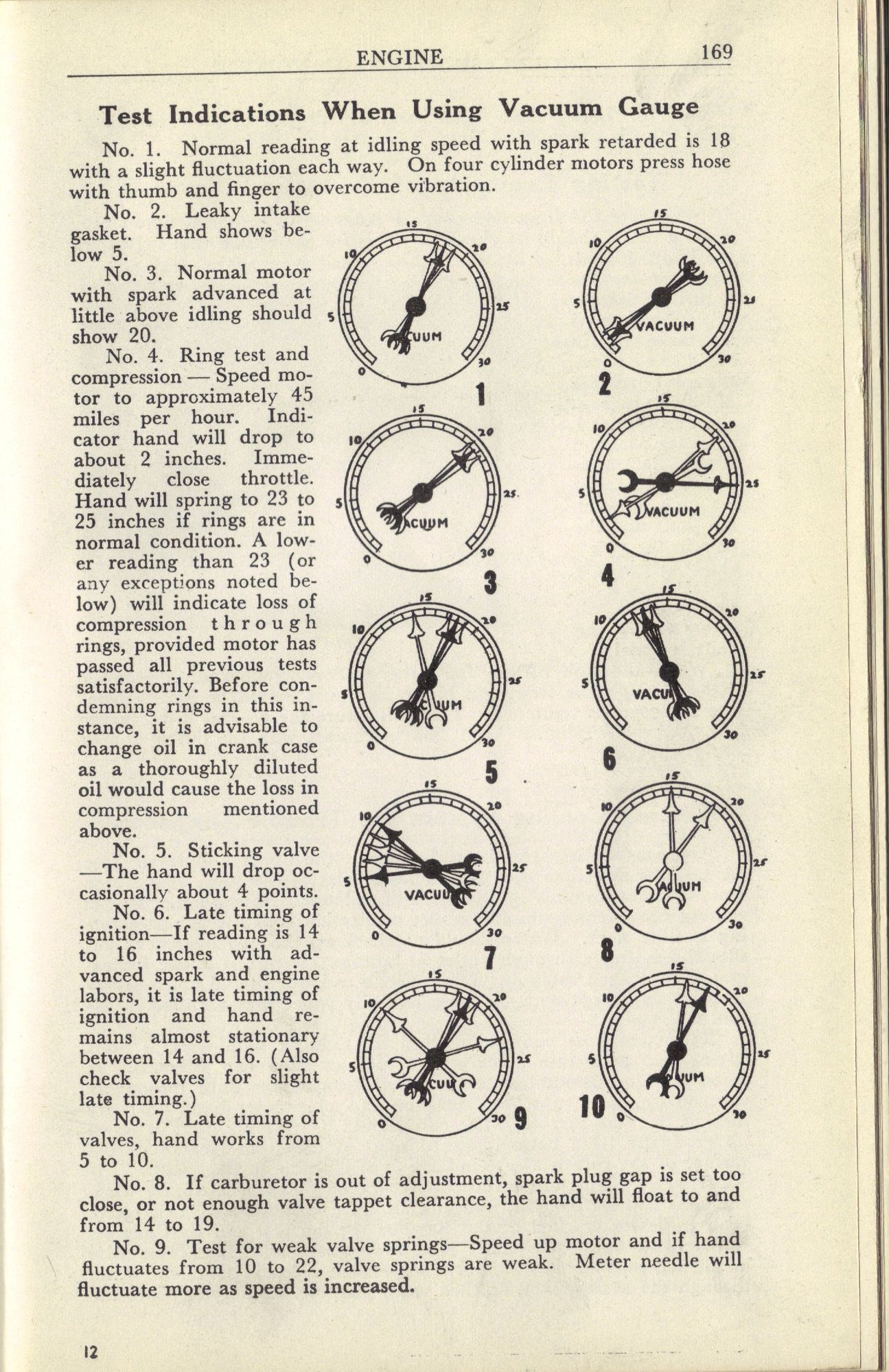

The vacuum gauges you get now are a vacuum/turbo gauge if you want to put one in the dash. You can see what's going on with this chart.
Some of the details might not be applicable as this is from a troubleshooting guide I have from the 1930's. The basics though on non-turbo engines don't change. (When's the last time you saw an electric hand shifter?)

So I'm guessing I found the right spot to test the vacuum, because I did get a reading. It bounces though while the car is running, is that normal? Also, I knocked on the converter, took a video of it, here is a link. https://photos.google.com/u/2/photo/...lYogcmMZ5WISpC It didn't sound like anything you were describing.

20 inches of vacuum is a healthy engine. As for the video, file not found. When it bounces, does it act like any of the illustrations on the chart I posted? From what I can see, it looks like you have the 4 banger. When was the last time the timing belt was changed. A sticky valve will cause a bounce in the reading.

Okay, let's try this, the forum doesn't let me upload a video. Here is me knocking on the CAT https://drive.google.com/file/d/1eL-...ew?usp=sharing and here is the vacuum gauge while running. https://drive.google.com/file/d/1qZl...ew?usp=sharing It looks like number 5 above. Seems to jump between 20-25
Yea its a 4cy. I've never replaced the timing belt so I'm not sure. It seems tight though and it was timed earlier this season, I'm not sure if it would have jumped timing? At idle, the car is really good, and revs up in neutral with no problem. There is no dash, so I don't have a check engine light.

Okay, th gauge is telling me there is an issue inside the engine. I'd do a compression check on the cylinders and after that watch the valve train as it's running. I don't think it's your converter or timing belt. I'm assuming you have the SOHC engine.
