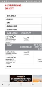

Can anyone explain why the 2017 Dodge Journey Crossroads Tow Capacity is lower than the Grand Caravan when both have the same 3.6L V6 engine and VVT transmission? 3,600 to 2,500 is a huge drop if only based on base curb weight or wheel base.

Completely different platform.

yep, gotta consider gvwr.
...and awd would lower the towing capacity due to the added weight and the rear drive unit is pretty small.
