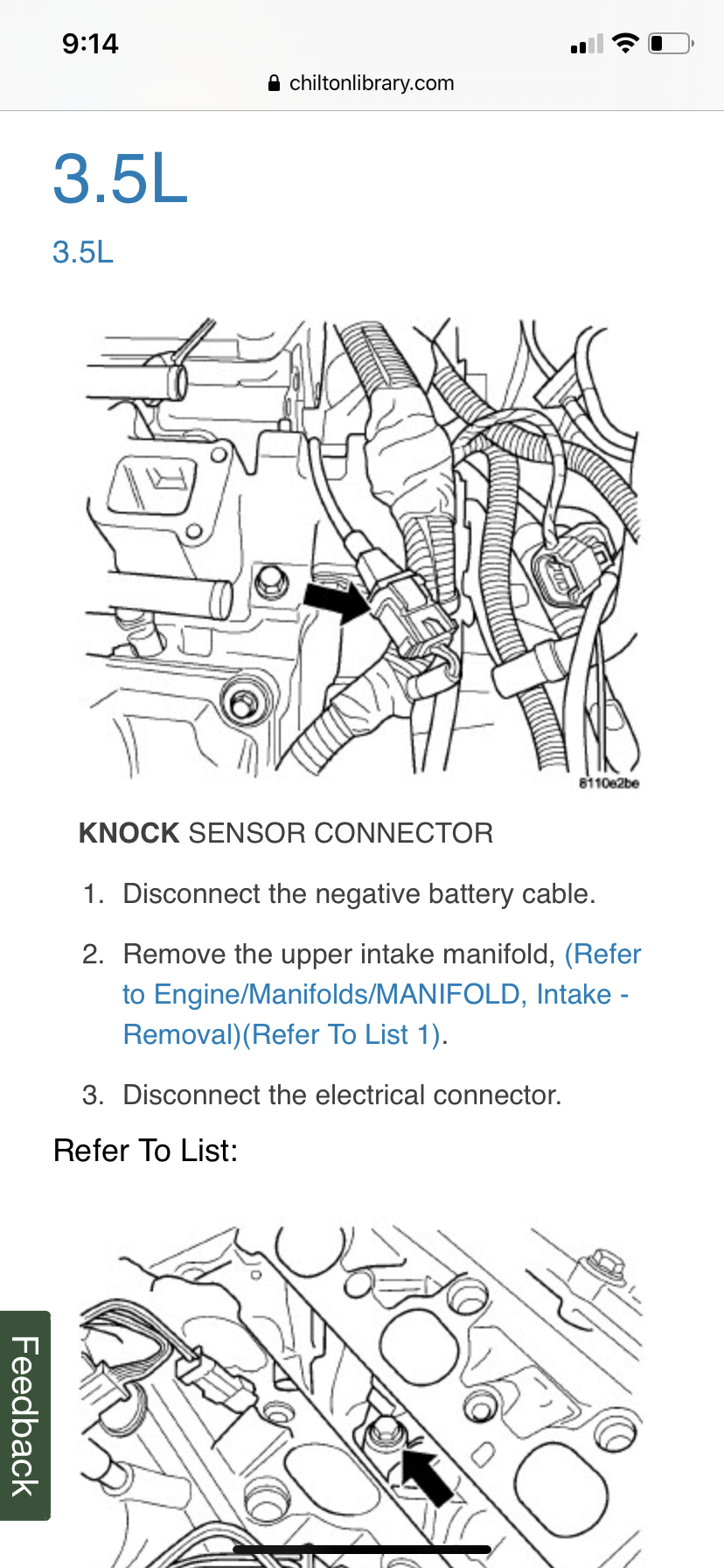

Hi everyone, I'm catching the following code: P0325-KNOCK SENSOR 1 CIRCUIT, with a check engine light. Symptoms are as follows: Jerking and dragging on the road, random misfire codes from time to time, and poor acceleration.
I'm convinced from the symptoms and the codes that there is no salvaging the knock sensor and will light require replacement. I've search all over and feel like I'm going insane, where is the knock sensor located? I feel like I might simply be overlooking it or its hidden somewhere I'm missing. Any assistance is greatly appreciated....
Note: I've looked online for diagrams and videos and can't seem to find anything worth its weight in finding the location.
I appreciate the help....

I hope this helps bud
