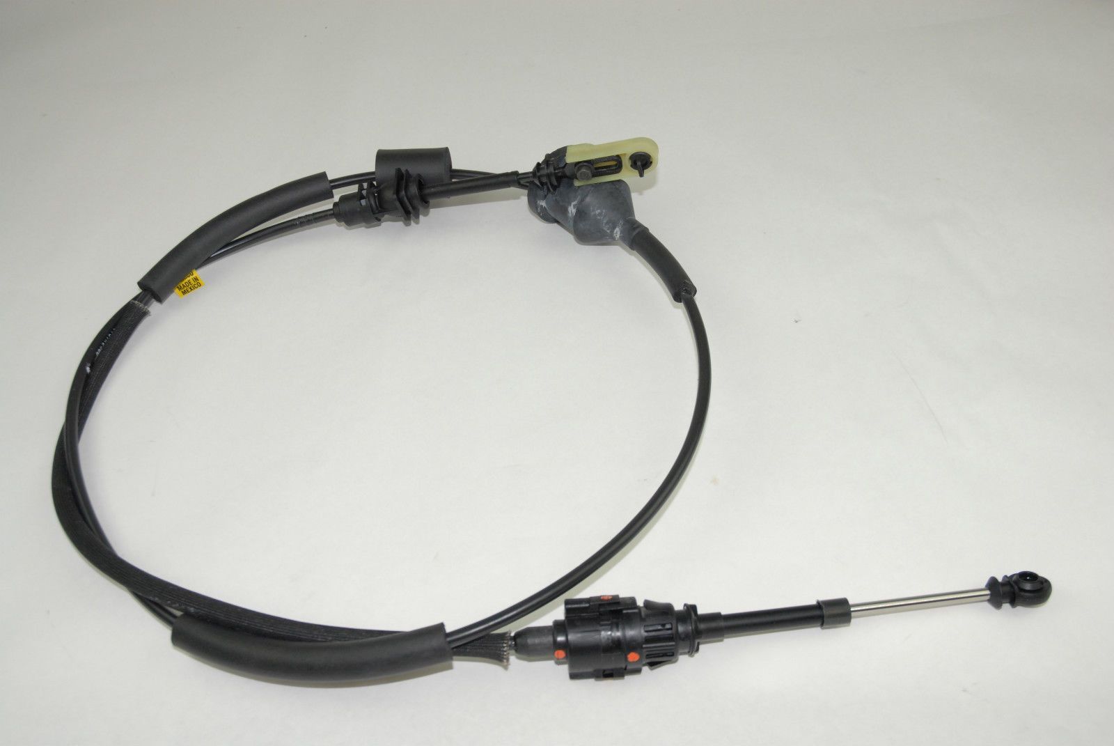

You're kidding right? No shift cable? Have you taken any parts of your Magnum apart? Fully electronic gearshifter didn't happen til 2011. Since I'm sure you will attempt to refute that, it is Mopar p/n 4578073AD, looks like this:
The engine throttle body is fly-by-wire, not the shifter. Please know what you're talking about before offering advice, this is how wrong information gets disseminated.
