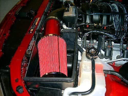

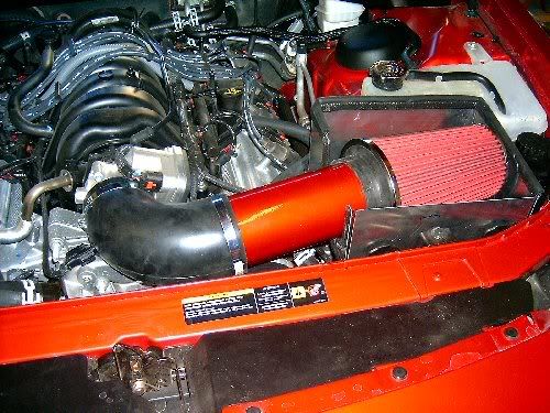

My personal recommendation is to leave the dinky intake tube on the bottom and add a cold air intake on top of it. The small tube on the bottom actually goes underneath the car to an air scoop. Kind of acts like a small ram air scoop. THere is one company that has a Cold air intake available for the Magnum and two are very close to releasing theirs. Airaid http://www.airraid.com has one available. 360 Air Intakez http://www.360airintakez.com should be releasing theirs within the next week or so. K&N has finished prototyping theirs but it is not released yet. Not sure when it will be released. My personal preference is for the 360 Air Intakez. The AirRaid unit does not replace the accordian style tube going from the filter box to the engine. Both the 360 Air Intakez and AirAid units keep the stock dinky tube on the bottom of the air filter box. 360 also lets you select the color of the air tube. They will powder coat it most any color you want. Here is a picture of one installed on a test vehicle:

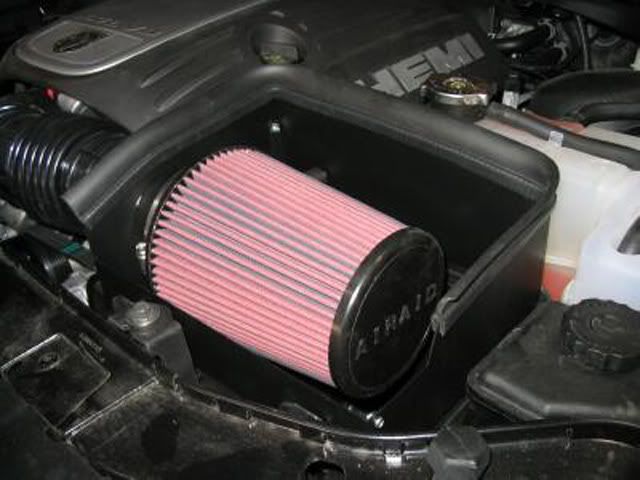

Here is a photo of the AirRaid system install:
