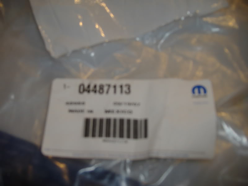

The Dodge part number for the positive battery cable is ~ 4487 113 (So says the Dodge/Dealer parts book dated August, 1992. Page 8-85). Note: The part number may very well have been superseded but is still good.

thats the same part # for the 93 ctd.

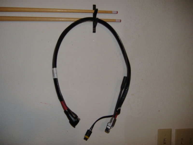

heres what youre getting...
(yea, this isthe 1 for my 93 ctd. I just havent installed it yet )

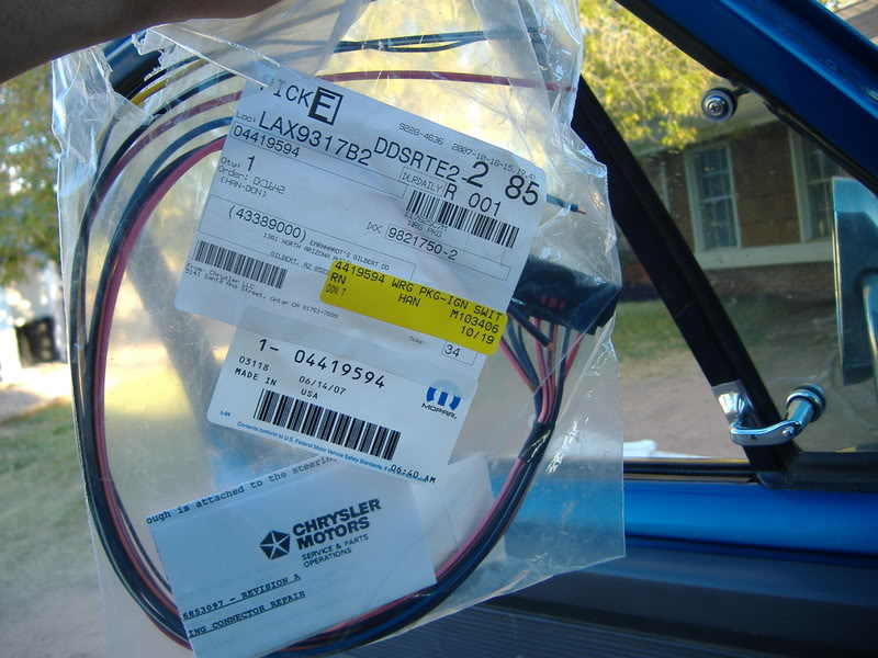

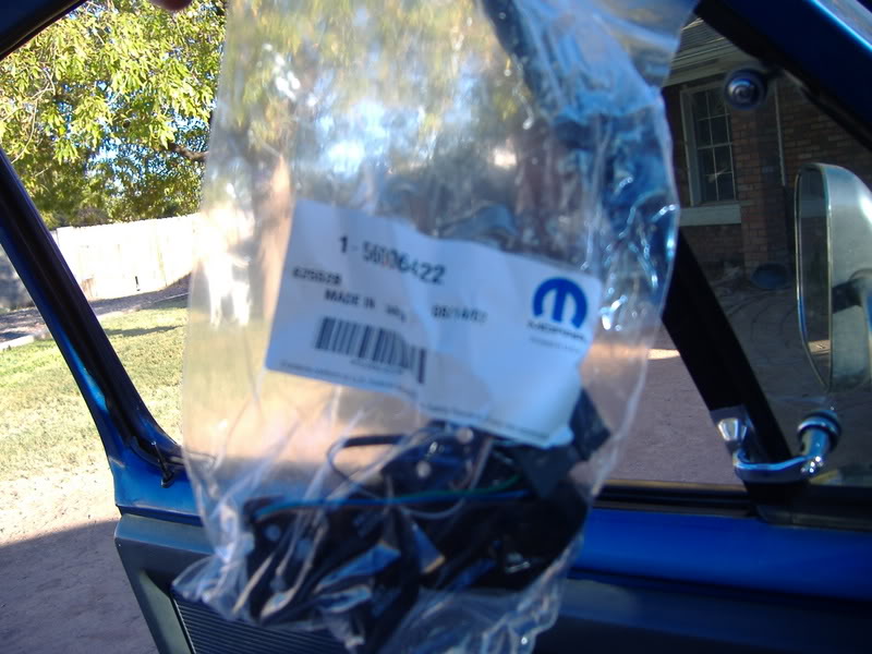

btw guys, you can still get the ignition switch, wire harness, and cruse control assembly from dodge...

the DODGE cable will have the extra circuit attachments for the starter solenoid, and some other goofy thing that has been hacked out of my truck...
