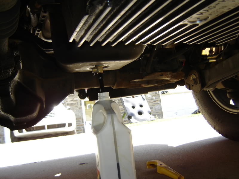

Since you are ordering from Genos and you are doing an oil change, I HIGHLY reccomend that you get the flipper valve. Nobody that I know that has one regrets putting it on their truck. You'll love it, I promise.

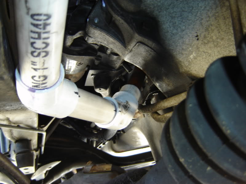

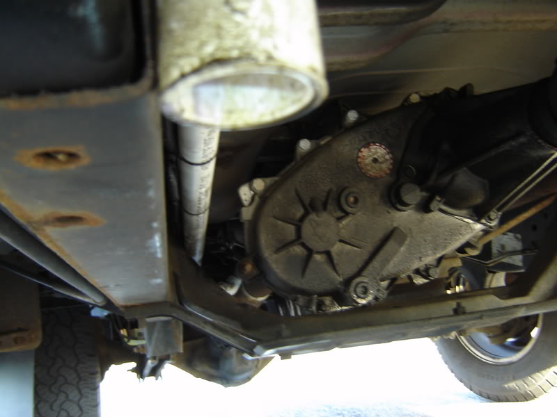

Just one thing with Rotella, after you change the oil and run it for a while with the new oil, especially at idle, it will smell strong of oil from the vent tube. It will cease after a few hundred miles but it is rather strong.
I relocated my vent hose to the rear of my Ram useing regular ole 1" PVC. As a result, I no longer have smell and messy oil issues at all. Another one of those fun, eay to do, and inexpensive mods.

alright thanks, and that lil drain thing hasn't gave ya any trouble? I would hate ta get a leak , O well I'll take a look at it, if it fits in the budget this oil change I might do it if not maybe next time

Aero, I've had it for almost a year now with no problems at all. Steve just got one recently as well. Those valves are AWESOME !!

hey mayfair whats this double action you gotta do to get it to work?

You have to push the lever in (or pull it out I don't remember), then turn it down. It's got a tab on it to keep it from opening inadvertently. I have one as well, $25 can't beat it.
