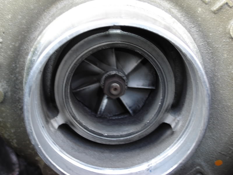

OK! It's comming out! I think mine was been spot welded in, but it is comming out, espescially if it will go back in! My truck is already LOUD and it gets annoying on some of the long trips I go on, the exhaust brake doesn't help the noise either. Maybe the extra whistle will cancle out the engine noise.
[IMG]local://upfiles/23352/B701AEA9A48B42BEA1AC74733D0A7F86.jpg[/IMG]

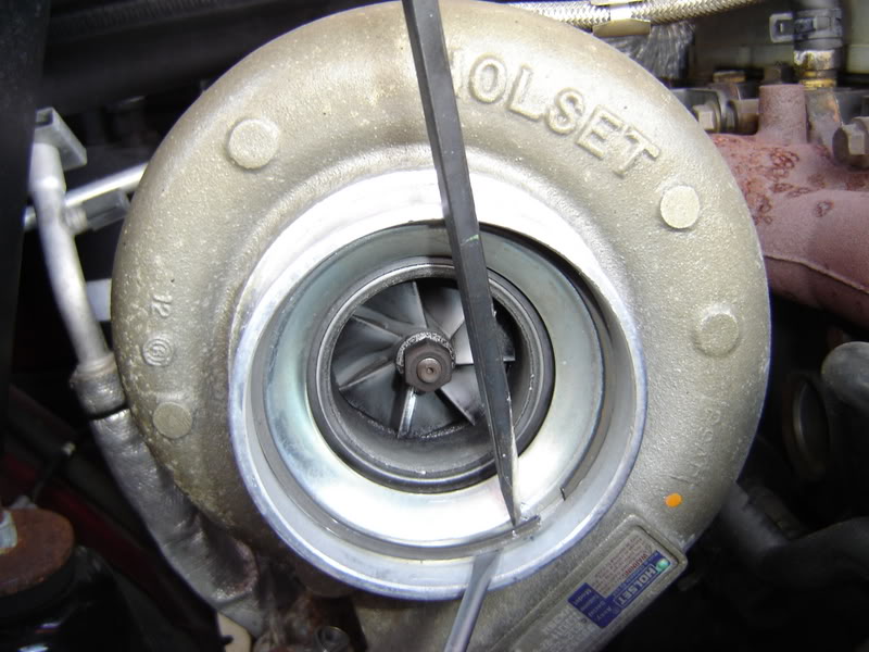

Here ya go ...
Just work a little screwdriver under the ring and give it a little twist with another driver
TAA DAA !!!
If you want it back in, just re-install the split ring. If you are at all worried about buggering up the turbo, put a little blue painters tape under the area where you start the screwdriver. You'll be fine though, and just rememer
