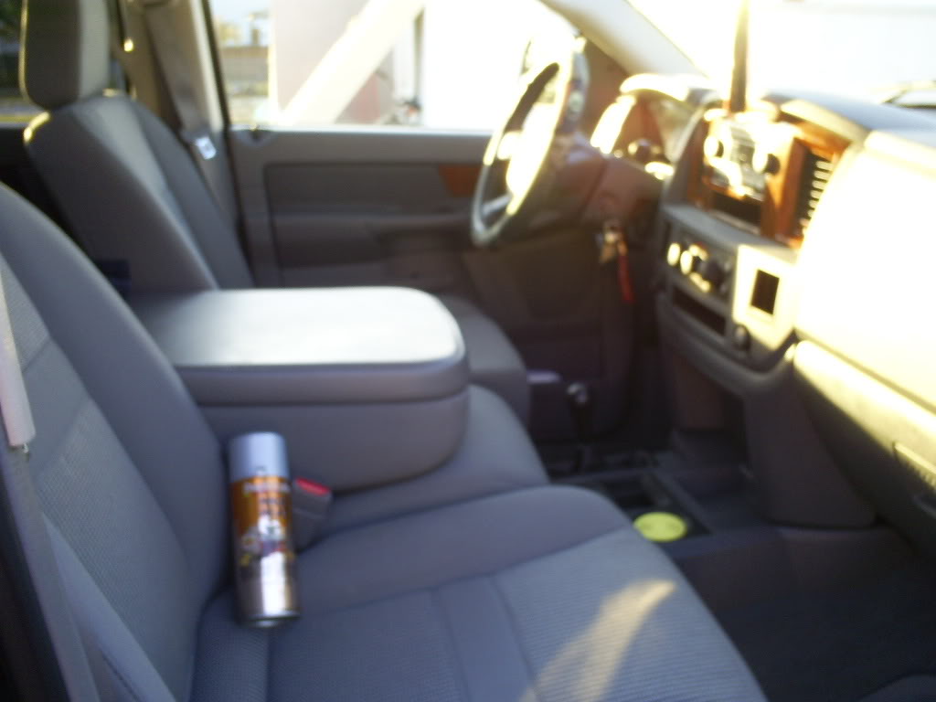

Where are the points to pop off the dash or where are the hidden screws? I've got the new style dash w/floor console, heres a crappy pic from my phone.

I am wondering that also. I tried to get it apart a few minutes ago to route the xm wires and nothing. I pulled hard enough that I know there has to be some screws because any harder and it would have broken.

I have the folding cup holder, but the rest looks the same. Under the cubby that is between the cig outlet and the power outlet there should be 2 screws under there. Once the 2 screws are out, the whole bezel pops out. It is kinda hard to get started, but once you get a corner popped the rest is easy. Hope this helps.

I just went through this, there are a PITA 2 screws that come up from the bottom and secure the bottom of the radio bezel. To get to them you have to remove the 4x4 shift ****, then the boot around the shifter then pop out the black drink holder and the little tray in front of the black drink holder inserts. Remove the screws to take out the plastics around the shifter and you can then get to the 2 screws.

I had no idea that all that floor consol had to come off I'll try to take a look at it soon.
Yeah I had the 04 with the flip down cup holders that dash came off nice and easy...their gettin more and more complex...

My previous '06 had the fold down cup holder...much easier. Next bit of advice is to leave the 2 screws out so you can just pop the bezel off if you need to later, trust me, it holds just fine without them.
