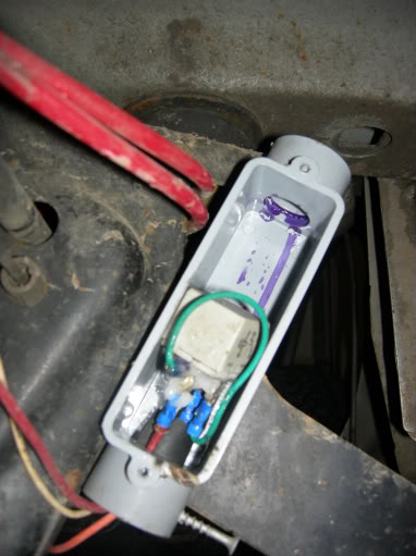

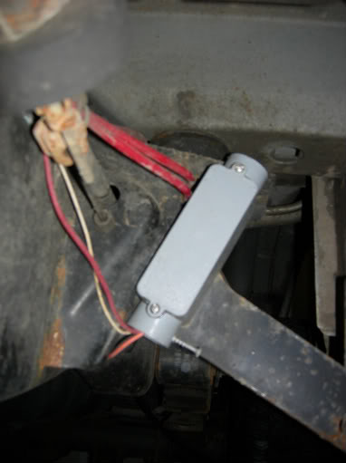

check out this hillbilly fix on my airbag relay. I went to use them the other day and they didn't work. Here the water and salt corroded the relay pins off. There wasn't anywhere to mount it close to the compressor and out of the weather. So I used this electrical box. It's got a plug glued in the top and a rubber stopper stuffed in the bottom to keep the water out. I coulda used the smaller size box but was afraid it wouldnt fit. Nice and dry in there now though.

That sure is a hillbilly fix, but what is the drywall screw for? Surely you could have found a stainless steel screw. Now you won't be able to get whatever it is that's holding off because now the drywall screw is going to rust.

That's holding the rubber stopper in the bottom. I didn't have a stainless one around. That one's galvanized for now. I might get ambitious and paint it all black.
