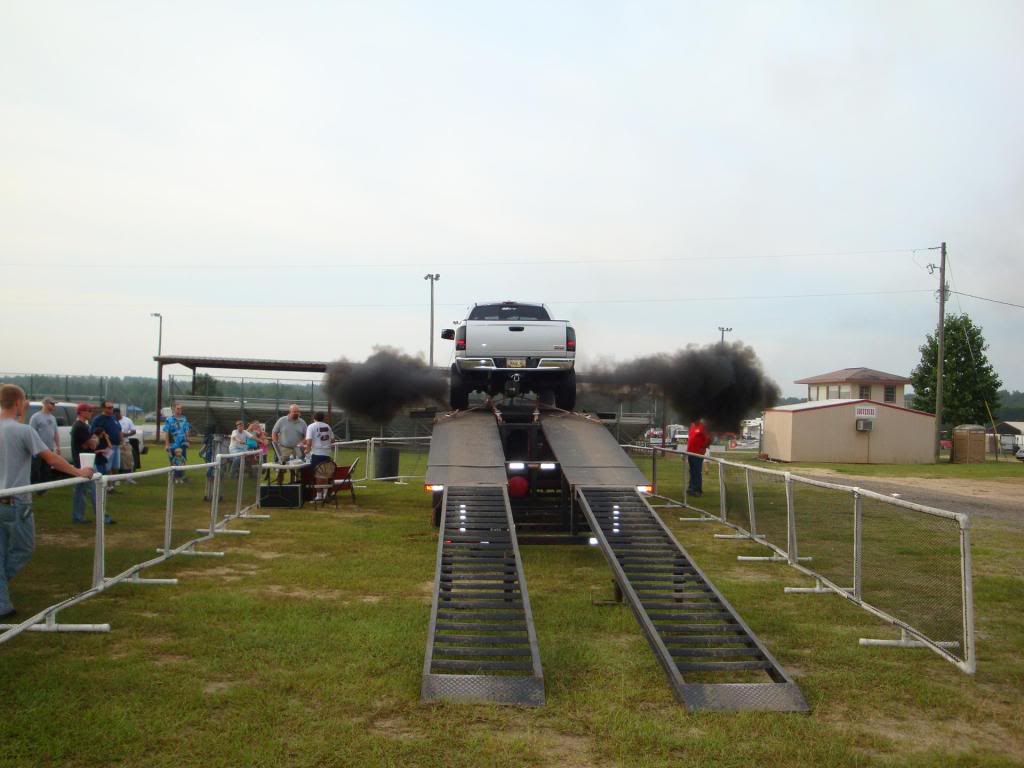

Nothing wrong with smokin' out everything behind ya on both sides.....

I should edit mine post to say you should get duels so you can smoke ricers on both sides of the truck
