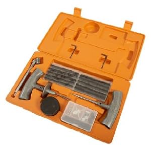

Puncture repair kit such as:http://ecx.images-amazon.com/images/...500_AA300_.jpg
