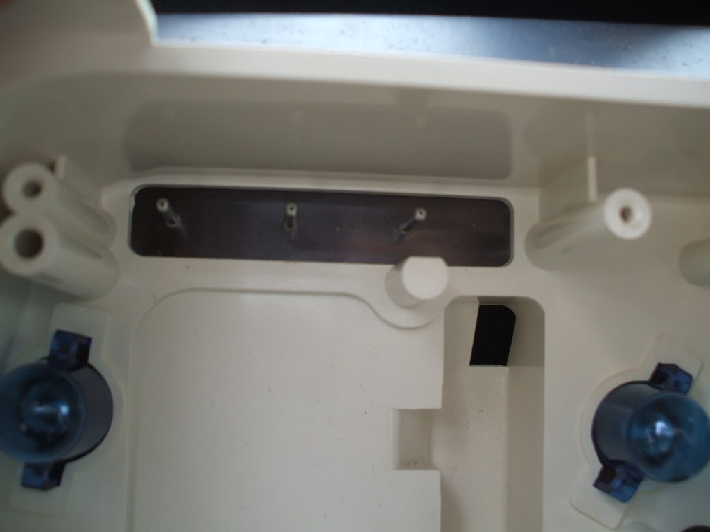

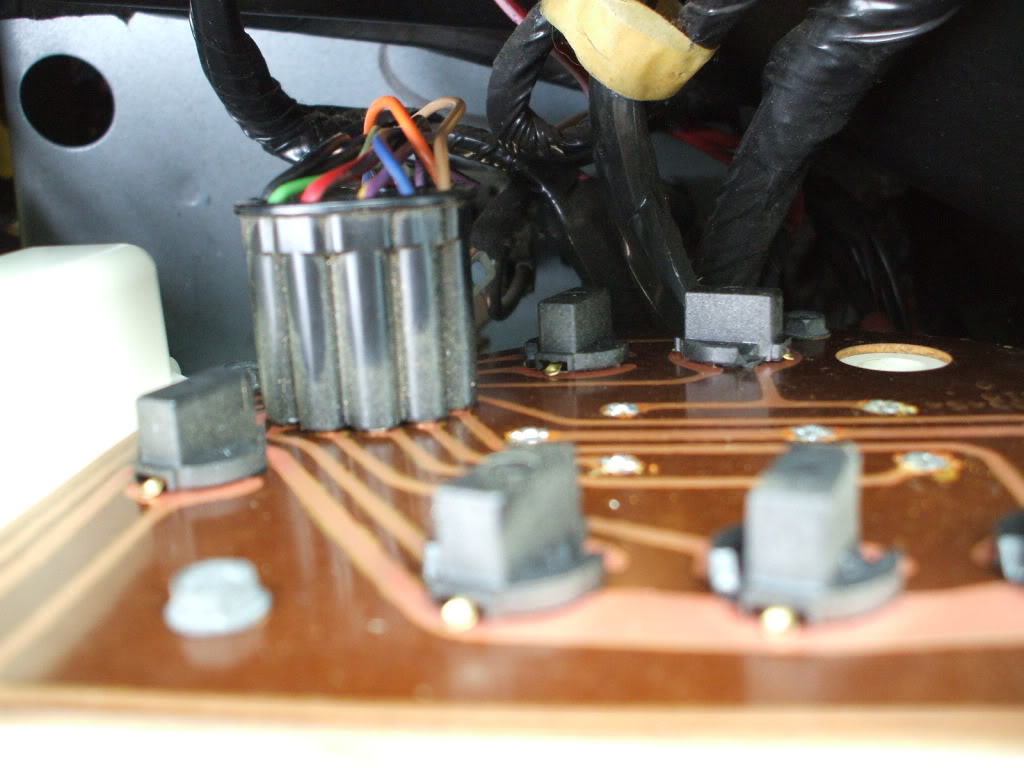

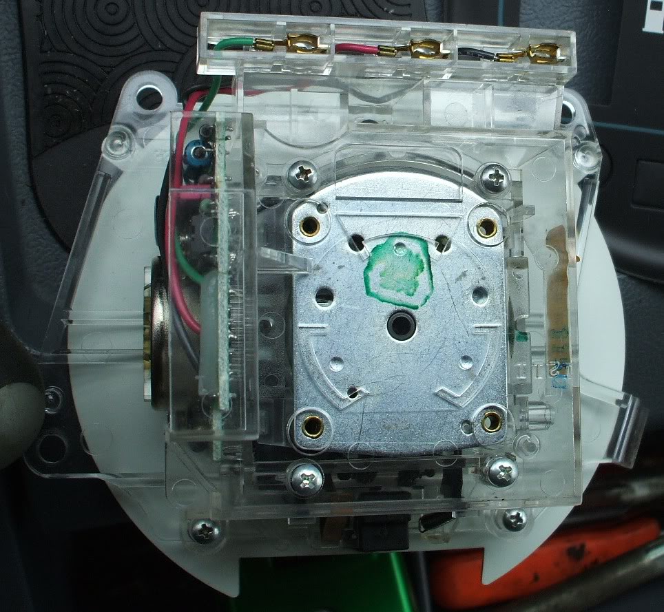

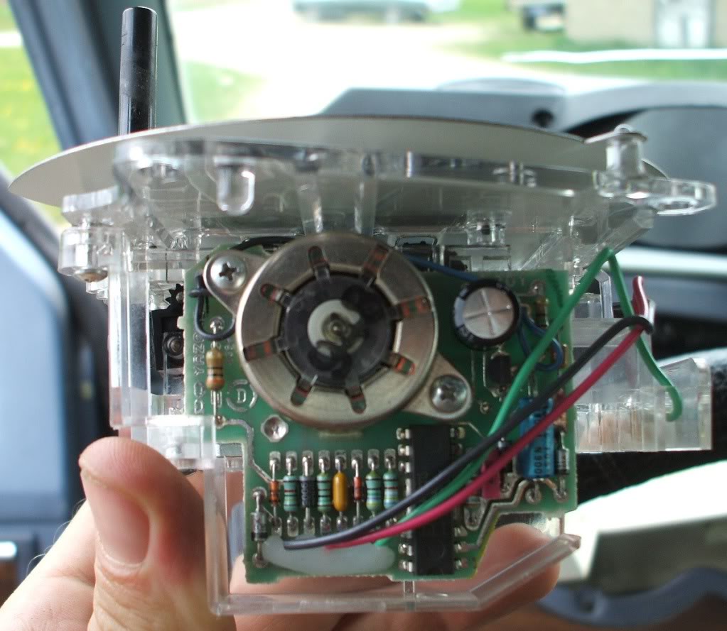

Well I took the dash apart again and took pictures of everything. Maybe you guys can see something I can't. Again I found nothing corroded or broken or unplugged. I could not get the plugs off but was able to pull them off far enough to inspect the pins and none of them are broken. The plugs themselves have no broken or pinched wires. So far nothing seems to be broken yet my speedometer does not work the majority of the time. So should I spend the $50 and get another speed sensor? And if that don't work change the speedo itself? Thanks again for any info.
If the odometer continues to work when the speedo does, replace the cluster. But if both the speedo and odometer stop working at the same time, replace the speed sensor.

Solder the contact pins to the PCB like I suggested. It couldn't hurt, and it's easy now that you have the cluster apart.

They already have pretty good solder on them. I also could not get the plugs off so I'm not going to put a heat source by the plastic plugs. Thanks though.

The harness contact pins do not come from the factory with solder reinforcing the outer circumference at their base to the foil tracers on the PCB as in my picture and description. Perhaps you have missed the point of my recommendation.
