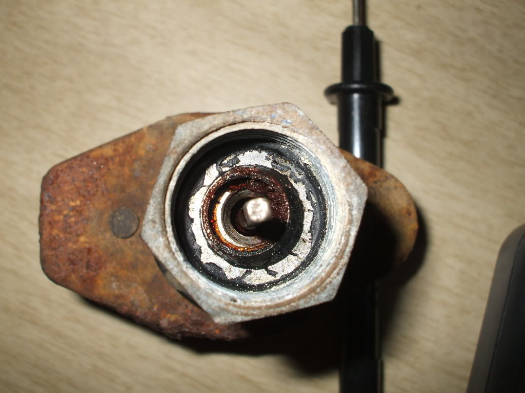

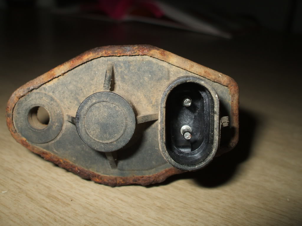

Ok so apparently there are no cables anywhere for the speedo. So I traced all the wires and checked all the plugs and they all look like brand new. I took pictures of the speed sensor and it appears to be fine. It spins freely and when you push down in the cable thing it springs back, I think it's supposed to do that. So it seems to be something with the speedo itself, and I can not remove it, so it looks like I might have to replace the whole.gauge cluster with the white plastic thing and all. Everything behind the dash appears to be attached properly and nothing is broke, there are no loose wires and nothing is unplugged.

Okay, I didn't realise they went all electronic in '90.
That VSS just connects right to the tranny right?
That VSS looks very similar to mine, except mine has an output shaft for the cable.
If your works on the same principal as mine, there is a spinning magnet inside. This magnet opens and closes contacts within. The speed these contacts open and close send a signal to the ECM, which I assume, on yours, makes the speedo work.
If you have a DVM, set it on OHMS, connect the leads to the electrical pins, and manually spin the rotor. the ohms should read 1,0,1,0,1 ect as you spin it. About 12 times per revolution.
Mine will get sticky, and work sometimes, then not others. I flick it with a finger and it works.

My van has about 130,000 miles. I can't get the cluster out, but if I can figure it out I will definitly check those pins, thanks. I checked my speed sensor and it appears to be working correctly.
