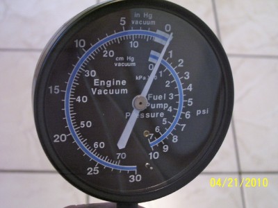

Okay, bear with me. I went out and bought a vacuum gauge. Warmed up the truck and shut it down. Hooked up the gauge to the end of the breather hose, then disconnected the pcv valve hose and sealed off both of the open ends. I started the truck and the gauge started moving to the right hand side of the gauge where it says fuel pump pressure. It hit 3 psi in about 20 seconds and I shut the engine down. Is this the right type of gauge? Shouldn't the needle have moved to the left instead of the right? Is my only alternative to replace the plenum gasket now? I mean this is a major job isn't it? Is this normal for a truck that only has 60k on it? Forgive my stupid questions, i'm not too sharp when it comes to working on vehicles other than the basic tune up type things.

One more observation (or stupid question)- If I disconnect the pcv valve hose and plug both ends with my fingers while the truck is already running the engine dies immediately. Is this normal?
