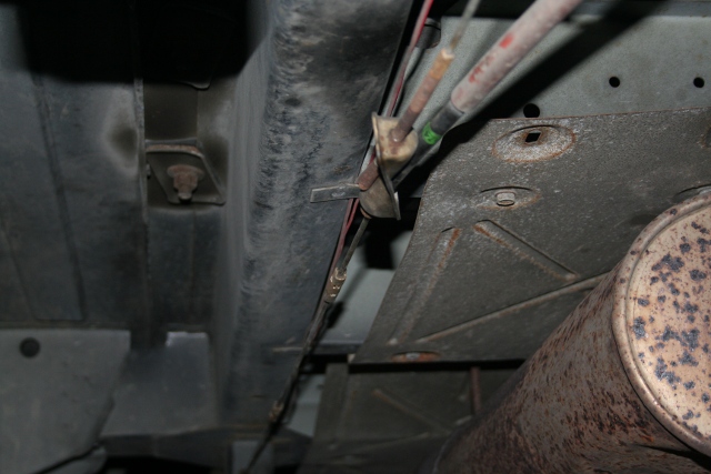

It could be that yours is different to mine. I tried to take a picture, but it's not that clear unfortunately:
The front of the van is at the bottom of the picture, so that cable comes from the parking brake lever and essentially is directly connected to the right brake drum via the bracket you can see on the end of the cable. The left brake drum is then connected via a cable on the end of the threaded rod - by adjusting the nut you alter the position of the threaded rod, and thus the tension on the left brake drum in relation to the right.
Is yours different to this?
Ben

The cable adjust on mine definately affects both equally. In fact one of the cables going to driver side has had some addtional mini cable clamps to pull it more.
