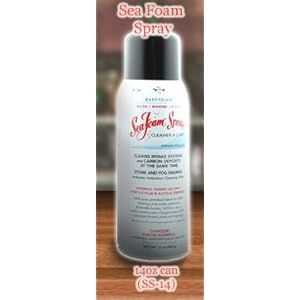

Spend the 10 dollars and get this Sea Foam aerosol. spray.
The above product comes out like wasp spray when used without the straw. I do not think the Deep creep Aerosol sprays out as viciously. Spray it without the straw down the intake while driving for half a can. Introduce it into the vacuum lines for half the remaining can, then stall the engine with the remaining quarter can spraying down the TB, and spray the rest into it. re install the air filter. Let it sit for 15 minutes, then drive it like you stole it.
Buy the liquid Sea Foam and put it in your tank with 12 gallons of 93 octane before driving it like you stole it.
If there is no noticeable improvement , the pinging is not being caused by carbon.

I wouldn't pour the liquid down the throttle body. The directions with the liquid say to pour it down the brake booster vacuum line. I don't think you could pour it fast enough to hydrolock it. Even at 800 rpm, think how fast the cylinders are moving versus how fast you can pour it in. At the most you are increasing the compression from 8.5 to 1 to 10 to 1 by introducing it by a can down the intake. But I would still not do it.
No danger of hydrolock with the aerosol spray, and it cleans the intake beautifully. My opinion, use the liquid in the fuel tank, and introduce the aerosol spray into directly into the combustion chambers.
But there is no no guarantee the pinging you hear is related to carbon build up in on aroung the combustion chambers.
