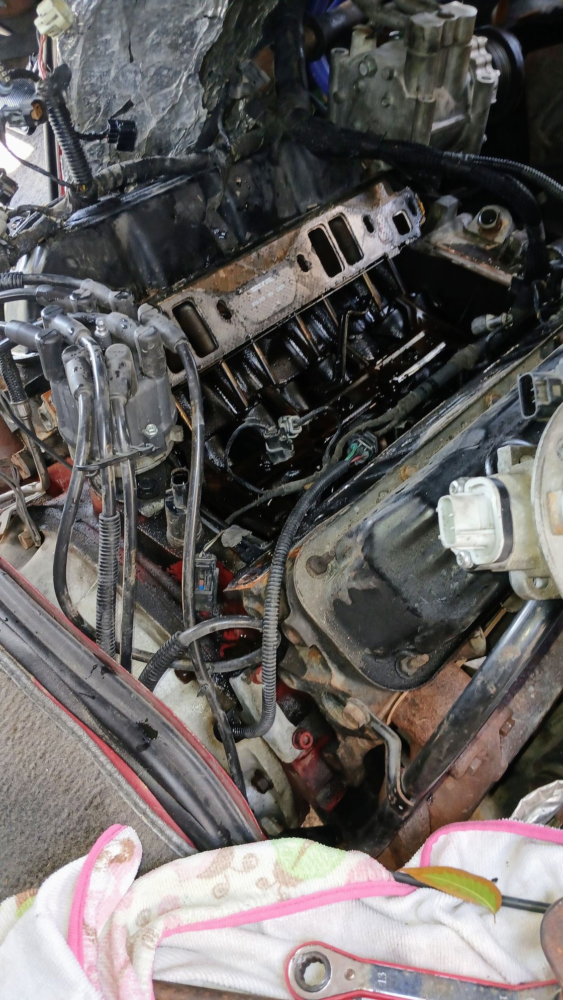

going to start tearing it down...
to get the lifters out, I have to take off the rockers? right? I remember being able to get to them without taking the heads off...but i think I had to take the rockers out...

I started tearing it down...not too bad..Ill post some pics tomorrow

almost got there today
