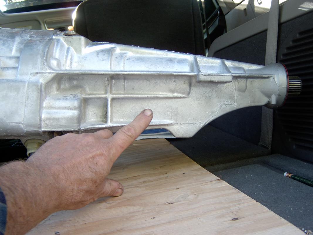

I just bought this trans but after i got home i have #1 on the tail peice my old trans has a wide 3 prong clip on the side held in w/ a big u-clip amd 1 bolt ///plulled it out and looks like speedo gear?//that spins on the sun gear -- what does that do ???/// my new one has none just a blank casting what does that do? //will it run with out that gear and 3 prong plug ///or may be swap tail pieses-----? SORRY HAVING TROUBLE W/ PICS

If transmission is the new one and old transmission had a speed sensor,Black with a clamp and bolt that goes into the extension housing. Then you have the wrong transmission.

I'm not sure I understand the issue.
However if this is just not having a place to mount the speed sensor. My '89 has a speed sensor mounted inline on the speedo cable.
I know it appears very similar to later years that mount the VSS on the tranny and use no cable.

hi they are both 46rebut if i install it will it run? or do the missing wires screw up the computer or is it possiable to swap tail shafts thanks

both are 4 speed // some one called the missing part [speed senser]

hi steve looked at pdf but its too recent they only show 47 series not 46 pehaps you can anwser this question --// my new trans does not have a speed sensor on the tail shaft my oter one did // what is its funtion // control speedometer--shifting ---overdrive part ?? because i going to put it in today and see what doesnt work or i can swap tail housings

the missing piece that was not on my new trans was a [[ speed sensor ]] it controls your speedometer and cruise control ,. so i took the guts out of the new and used the old houseing and shaft that had the gear on it /////// put it in //every thing works but my key start had to jump w/ screwdriver i checked the neutral safety switch its ok [middle pin goes to ground // today i am going to try to reset the pmc /// one other issue this truck i bought has a alarm system ,,maybe it is disableing the key start or bad ignition switch?
