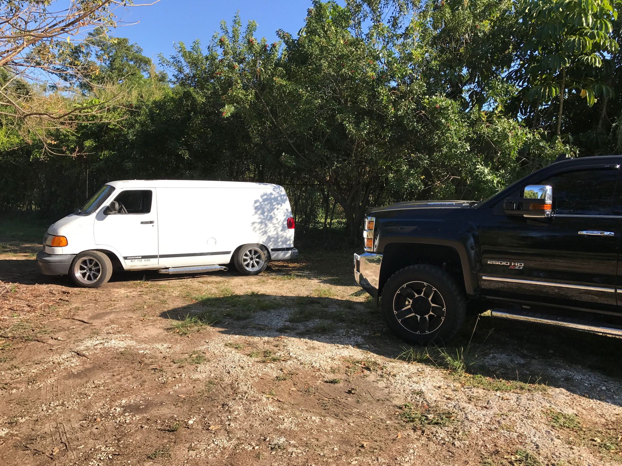

Here's mine

2 inch front and 2.5 rear drop
No rub in rear
it will work with some modification, it was design for the Dakota, so make sure you have the calipers for that vehicle, the holes for the van is wider that the one for the Dakota , also you have to use the ball joints they send.you for the lower control arm since it's bore is different on the spindle, this is not an armature install, so make sure you have some kind of technical/mechanical experience before you tackle this job....as for the rear I did a flip kit and weld it onto the rear end, didn't remove any leaf springs, and roll the fenders, it rides real smooth for a drop van, no bounce at all, also remove the stock bump stops.
