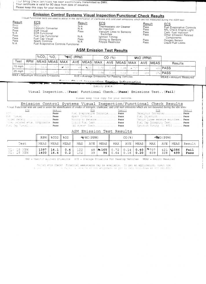

2011 NO was great. 4,000 mi. ago. Not yesterdays. sorry.

Thanks for posting that. I find it interesting how much different the allowable maximums are. Is yours a 3.9 or a 5.2 or a 5.9 liter engine?
Mine is a '89 with a 5.2 and I am allowed the same HC as you, but .50 and .64 on the CO% (yours are .72 and .64)and 1010 and 870 on the NOppm(yours are 707 and 609).
The averages listed are different on my test sheet also. On yours HC Average are lower, CO higher, and NO lower
My percentage of measured o2% is 2.7 and 2.5 and my HC's were 86 and 60. Your 02% is 0.4 and 0.2 and your HC's are 165 and 94
This suggests to me that my air pump is allowing further burning of the HC's in the catcon, and perhaps yours is not injecting enough/any air into it to facilitate the burning of the extra HC's and giving a low 02% reading at the tailpipe.
Notice on your earlier test, which you passed, had a higher O2 % of 1.7 and 1.8.
My c02 percentage was 12.6 and 12.7 respectively, the rpms about 40 lower than yours.

My Magnaflow Ca legal Catcon was new and installed a few months before the 2005 test below and each test afterward, the NO has increased a bit, for the most part.
Wish I could find the '07 and '09 printouts for comparison.
Notice they lowered the allowable CO sometime between '05 and '11.
I guess all they will need to do to get these old vehicles off the road is lower the allowable emissions to ridiculously low levels that few could ever pass.
