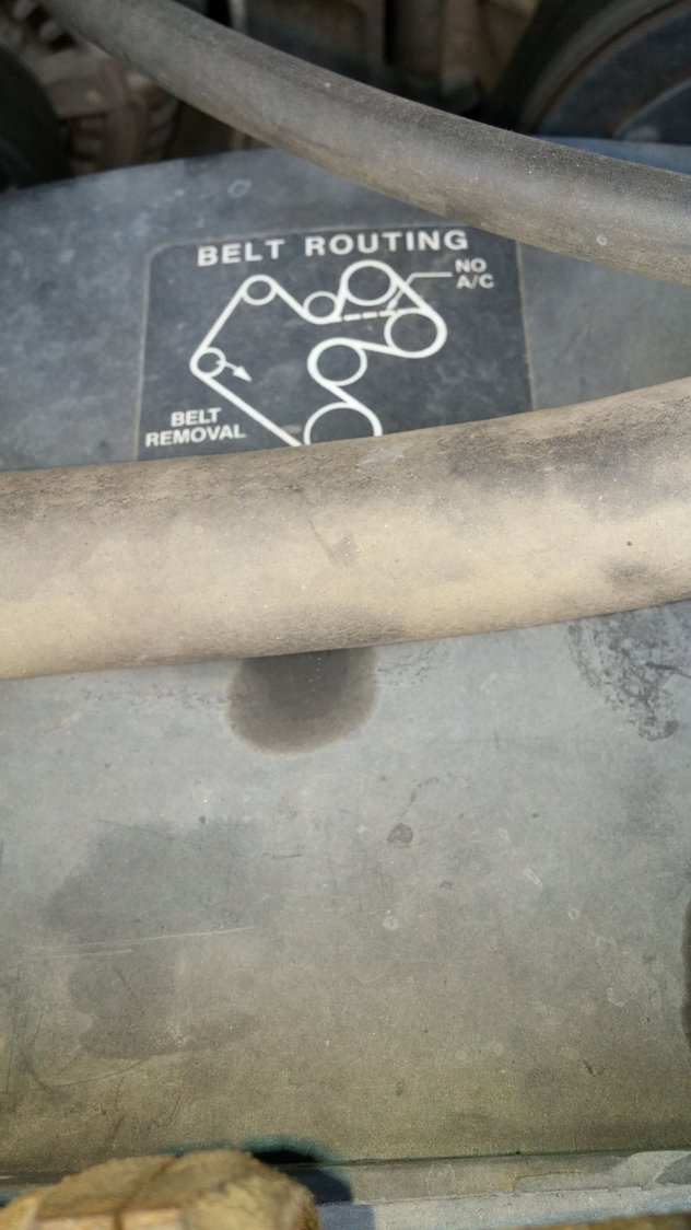

This is the diagram that was under my hood. Question? When I put it back on do I follow the same pattern as taking it off?
Old Dec 8, 2014 | 03:33 PM
Posts: 28,205
Likes: 363
Yes, or course. Any other pattern may make some things run backwards.
