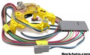

It's probably worn out. You can get a new switch from rock auto. Requires removing the steering wheel to access.

Do you think its necessary to buy both the "lever" and the turnsignal switch, or just the turnsignal switch behind the steeringwheel??
lever / cruisecontrol, washer, turnsignal
turnsignal switch

Get them both. You don't want to have to take it apart again.
