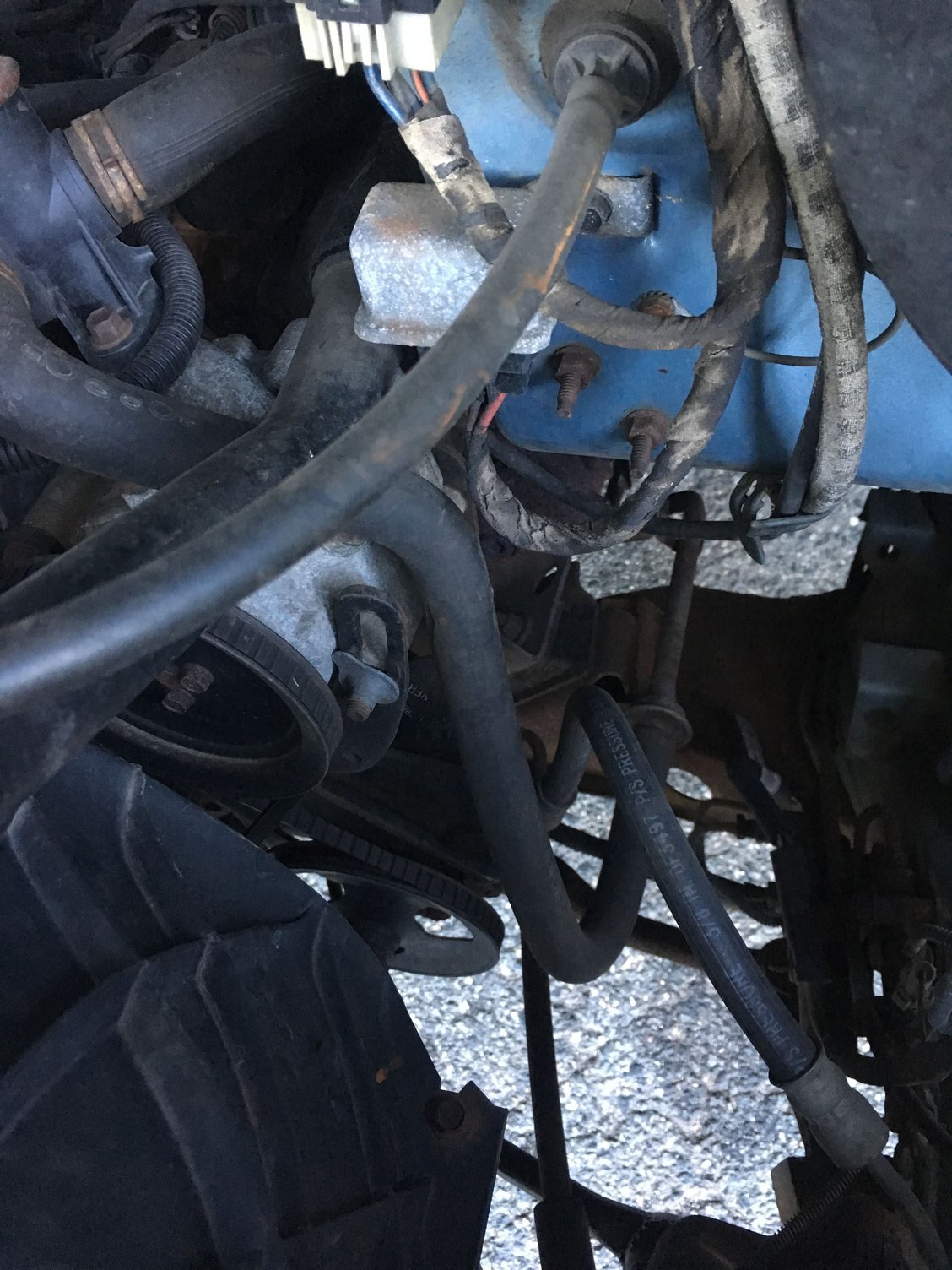

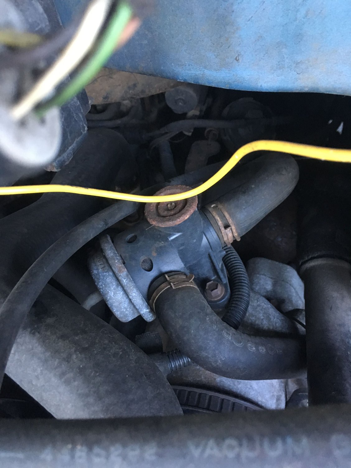

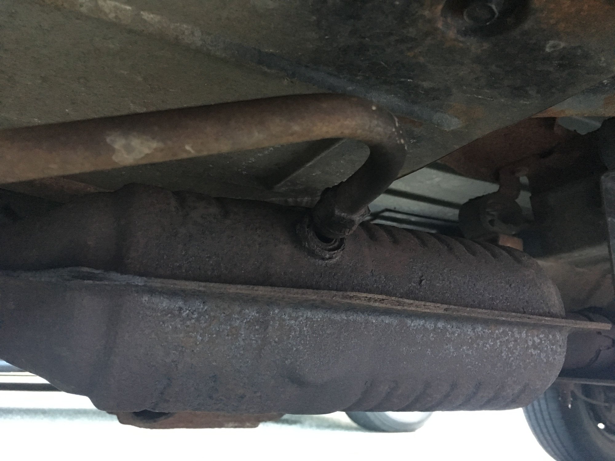

And could this be why my van is running poorly?
Disconnected here...
Runs up this way...
Ends up here

Air pump tube. By pumping air into the CC it causes unburnt fuel to burn. This reduces emissions.

Does the nut on the end of the pipe spin? Did mine snap in half?
It's supposed to spin, and yes it looks like it snapped off.

The replacement catalytic converters come with a chunk of silicone hose to join between the pipe and the new cat. There is no way you are going to fix that.
Steve
You don't think I can drill out the broken part and put a new air injection pipe on? Or if the threads are damaged have someone weld on a nipple and just use hose?
