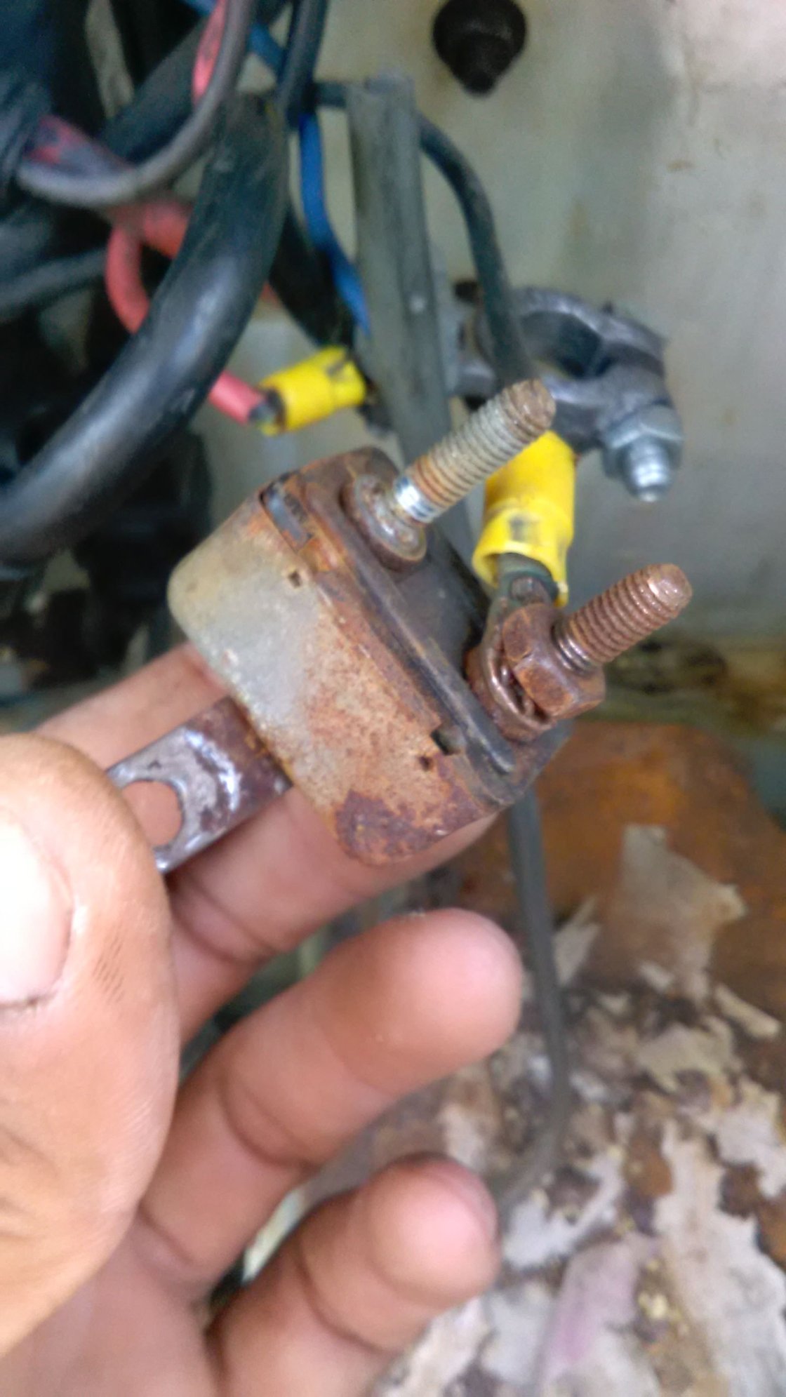

Yea I didn't get a chance to check it out today, but first thing in the a.m. I'll do that. I know for certain the only area I was working on was the battery terminals and the ground that was with this thing that I believe is a circuit breaker. Question: as you can see in the pic it was pretty rusted so I couldn't read it, does anyone know the correct amps I should have replaced it with?? Would a higher amperage than what it should be cause these kinda problems?? Person at the auto store said 40amps is what it usually is, others told me 20amps...I went with 40

20 amps or 40 amps does not matter... bad connections at the yellow splices which are rusted on the wires are probably to blame. Put a good pull on the yellow wire connectors and you will probably find they will pull off... get some new ones and crimp them on shiny clean wire that you have treated with contact cleaner and sand paper to get off the corrosion on the wire... those yellow crimp connectors usually do not stand up well to wet corrosive (near the battery) environments

Success!Not only did I fix the lights issue but got the stereo slappin!!!!! So I did as suggested went back where I was fiddling around and seen I had accidentally swapped a ground wire with the trailer hitch wire....and being curious if the new circuit breaker would fix the stereo issue and sure enough it did. Thinking back now,i remember what happened was when I was making adjustments to mount the sub and amp I forgot to disconnect the battery and accidently arcked the positive and negative...and i guess that fried the breaker. Thank you guys for all the help. Much appreciated.
