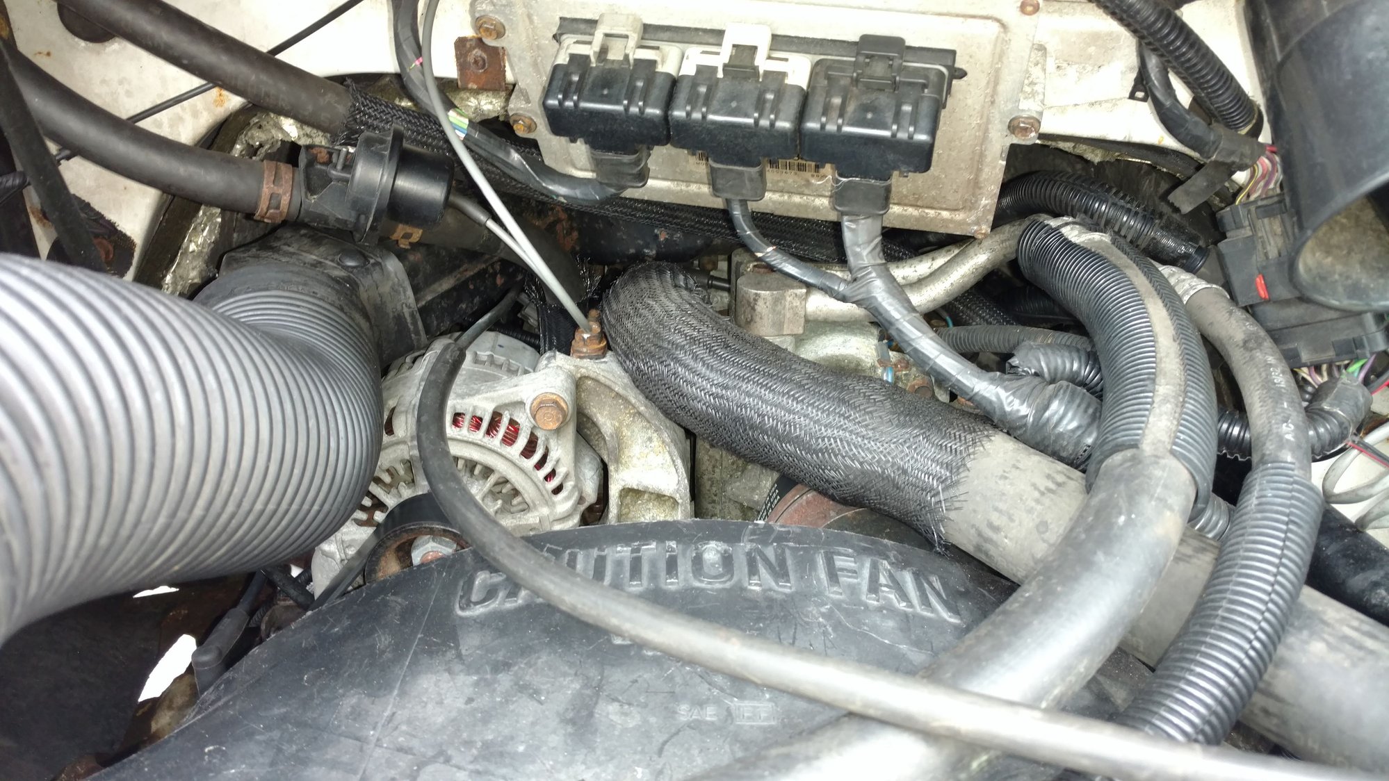

Good pics, looks like things are coming together well for you and hopefully the exhaust manifold hookup went better than taking them off!

Final update: I finished putting it all back together. I did a compression test on #6 and got 160 PSI, so good to go. I took it for a test drive and it drove perfectly. I had my scanner hooked up so I could monitor for any misfires and all 6 cylinders still showed zero misfires after 20 miles.
All back together and running good.

You da man alloro, looks wrapped up nice and professional too. Thanks for showing us how it's done right, great job.
