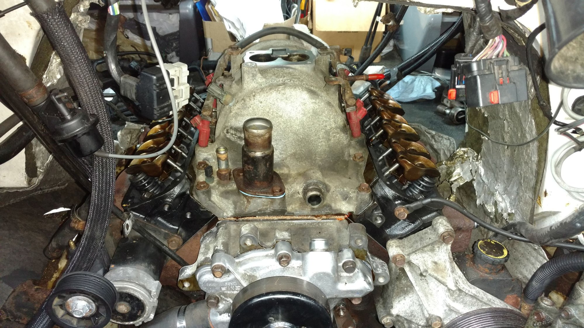

New timing chain and tensioner in place.
New roller lifters all the way around.
Reconditioned heads are in place.
Old Jun 6, 2017 | 10:09 AM
alloro's Avatar
alloro
Van & CUV Section Moderator
Joined: Nov 2006
Posts: 5,371
Likes: 115
Raining here today so I'll be taking a break, but here is where I'm at now.
Timing cover, damper, and water pump are all back on.
New pushrods installed, rockers installed, intake installed.
Passenger side valvetrain and exhaust back together.
Driver's side valvetrain and exhaust back together.
