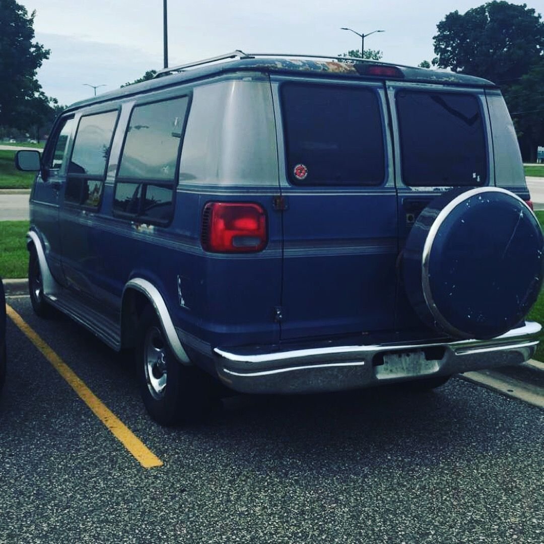

Hey all,
picked up a 1996 B2500 conversion van 5.2 for $200. Been sitting for quite some time. 119,000 miles. Replaced all the fluids I can in it.
Fresh brakes all around.
Engine and trans are in phenomenal shape for its age
EXCEPT
Been getting low oil pressure after engine warms up.
Swapped oil pressure switch with no effect. oil and filter replaced.
Would a new screen help? Or should I go the whole nine yards with the pump as well?
