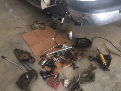

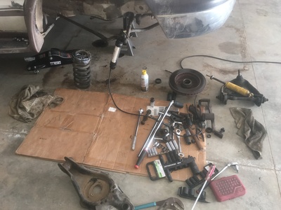

Well due to the cheap chinese ball joints blowing out on my less than 2 year old, completely rebuilt front end...It became absolutely necessary once again to tear into a complete front suspension rebuild...Hopefully this time with name brand parts...might not be parts made here but at least they have American names...
As I alluded to in my previous post, a floor jack is more than sufficient to ease the lower control arm down and relieve the spring pressure...
Total teardown time on this side, about one hour, all with hand tools...still don't have a shop compressor to run air tools...
Hope this helps.
