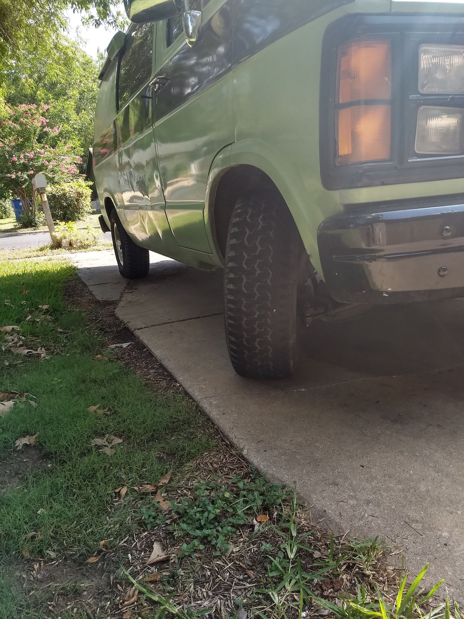

Anyway. I was able to center everything with the tie rod adjustments, but its still turning about 10 degrees to the right when in motion, forward or back. So, I guess thats a separate issue entirely. I suspect my ball joints, at least on the right side are shot. When my passenger tire is turned to the right it leans out big time. The camber is out of whack when its turned to the right.. When the tires are straight, the camber is looks okay though. This is not something I want to take on myself though. Anyone have any thoughts on this?
It actually does look a little better now, but it still seems off. You cant really tell from these pics, but here are a couple anyway.

May be control arm bushings as well....
