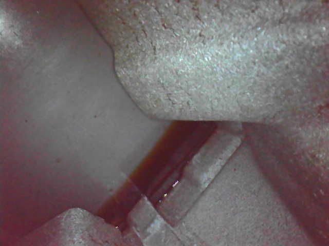

probed a camera down the intake. The complete plenum looks really clean but there is a decent amount of oil back in 1 corner. I'm not sure if this is normal oil from the pcv valve. Anyone have any input.

Use your camera to look at the gasket area where the steel plate meets the aluminum manifold, might be able to see if the gasket is out of place.
That isn't a lot of oil....... but, still not a promising sign.
haha. I'll take a better look tomorrow. Saw I can change the resolution on the camera as well. I'm still hoping for the best
