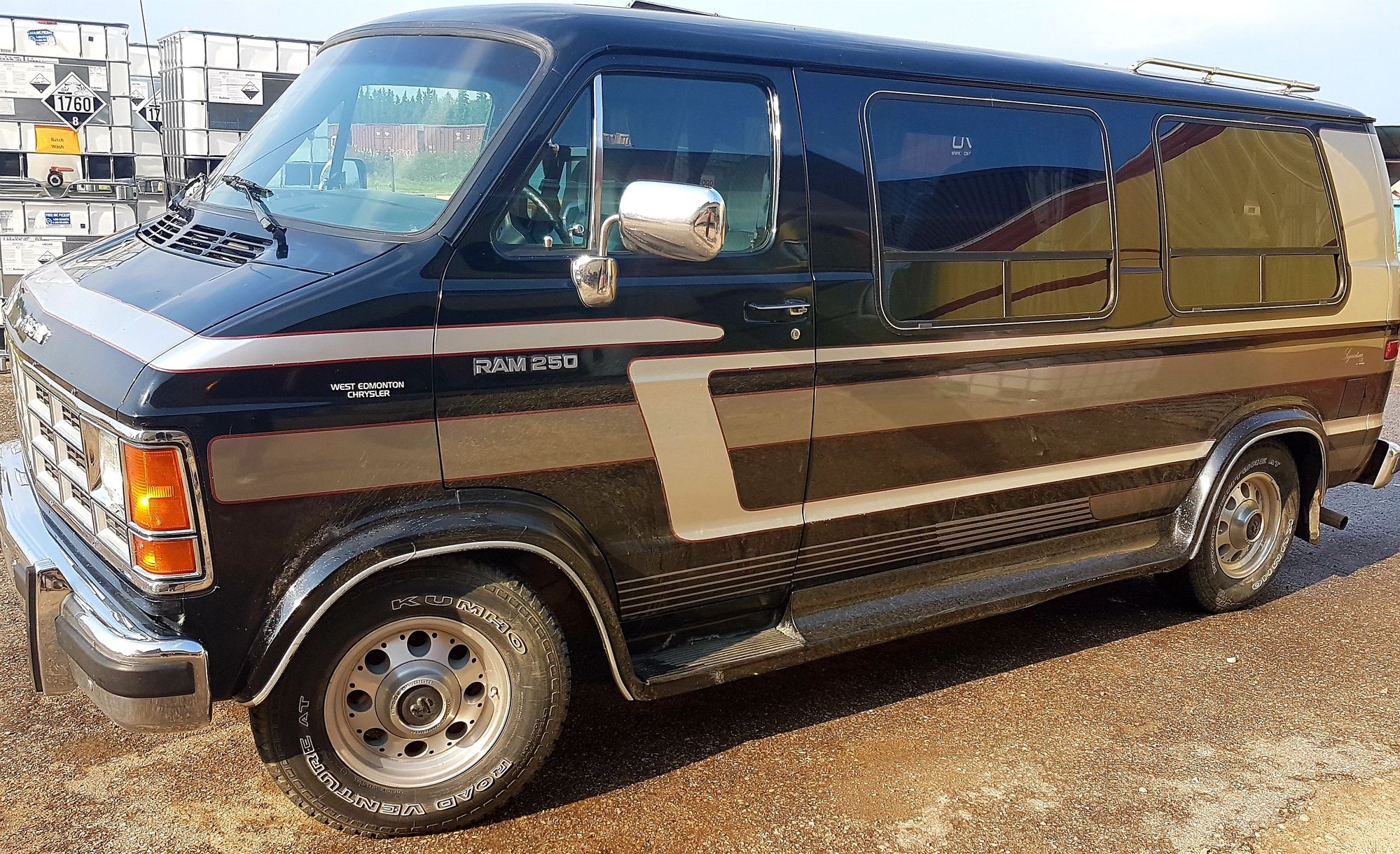

I recently bought a 1993 Dodge Ram 250 Van (318)
with about 200,000 km's on it. Everything works really well in it but once I get it over 90km/hr it has a slight engine stutter. Like it's mis-firing. Accelerates fine & decelerates fine but when I level off and cruise at 100km/hr or so I get a stutter in the engine. I've replaced the plugs and wires thinking that was the problem, but it wasn't. The van had sat for a couple years so I filled it with premium fuel & put some fuel conditioner & injector cleaner in it also. Any other advise on what else I can look at to fix the problem? I've put about 500kms on it since I bought it and seems to be ok. More annoying than anything... Would just like to get it running properly.
