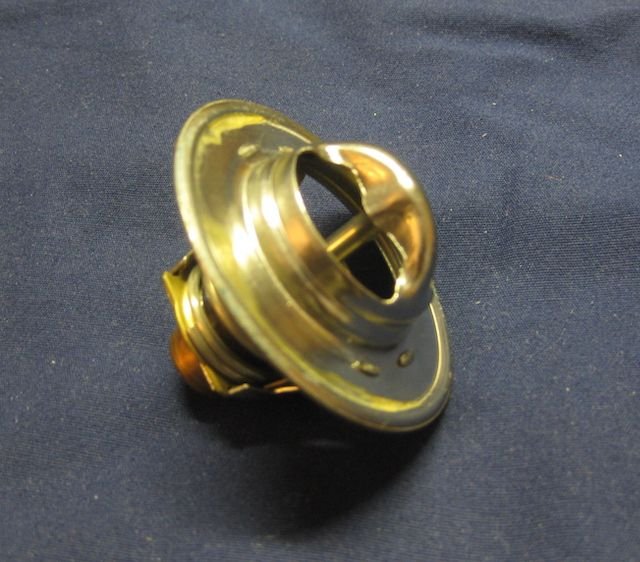

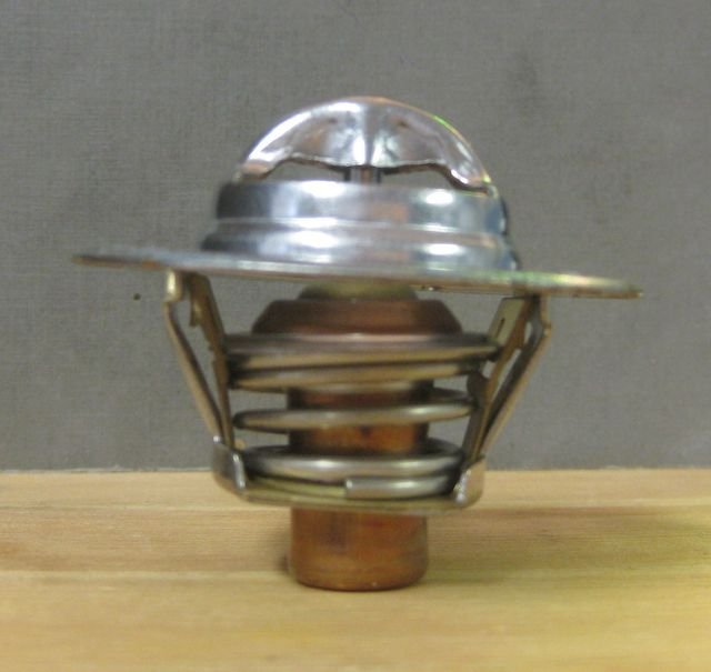

If you mean the fail-safe thermostats, every single one of those I've put in failed not long after. I've worked on several vehicles that never made any heat in the winter and those had failed fail-safe units too. I go with a regular old style thermostat. I drill a 1/64 hole in the plate and slap it in.
Originally Posted by SteveR
Yes, I meant to say fail-open thermostat. I used the one and never again.
Here's the old thermostat... stuck open or?
Definitely stuck open. The flat part with the spring against it ought to be up in the upper plate at room temperature.
