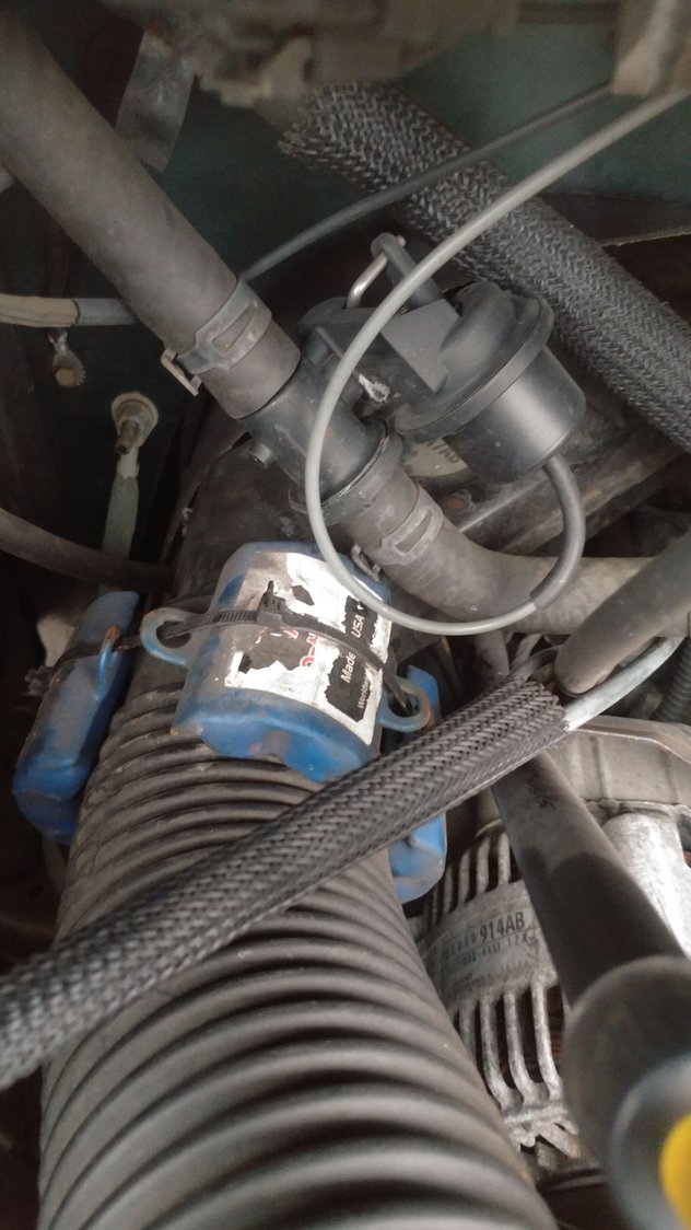

Third I have these packs on air intake(pic included) any ideas. Also have a red pack same design on fuel rail

The funky blue things, (and likely the funky red things as well) are snake oil, and do nothing at all. You can remove them without consequence.
