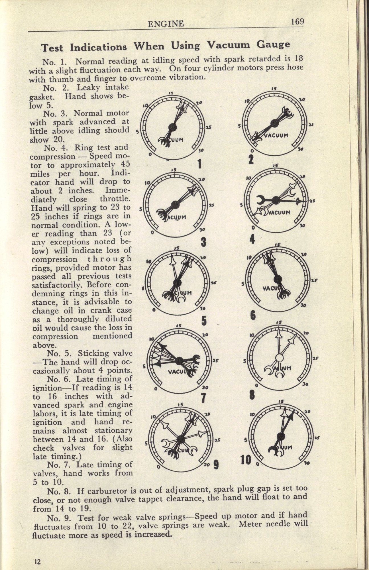

How many miles on the engine. Your timing chain may be worn and it's off a bit. Does the heat seem cool and the engine doesn't warm all the way up? It sounds like you used a mile-o-meter for a vacuum gauge. Granted, that's what it is, but I use a regular gauge. This one is a good 25-30 years old but it will read the innards easily. Plus it responds fast.
The above chart is a scan from my 1936 copy of Troubleshooters Handbook. (NO! I din't buy it new.) It may be over 80 years old but engines still oerate on the same principles.
