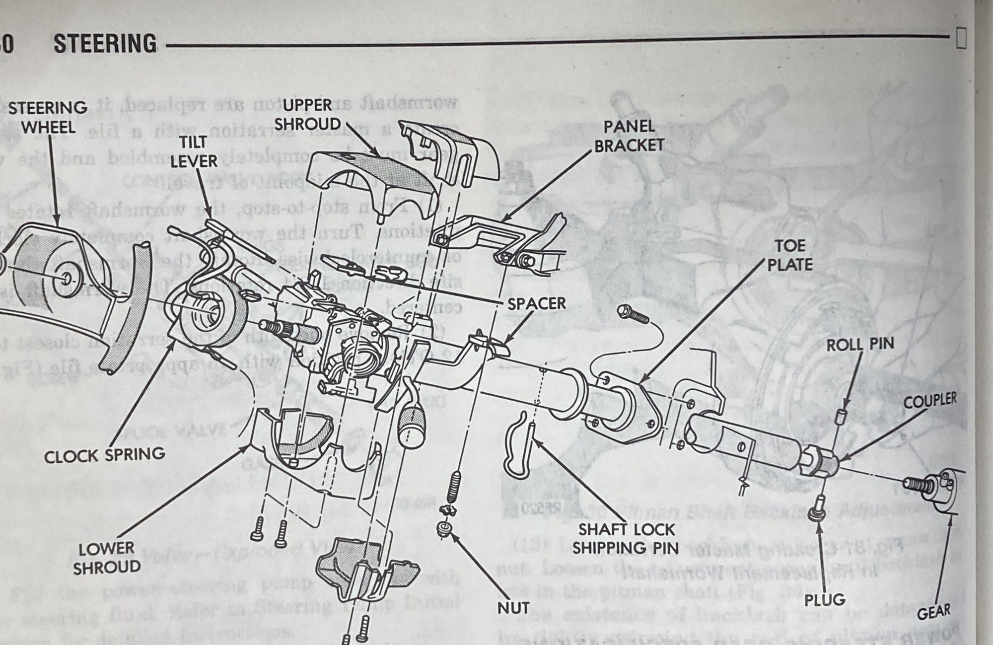

Also, wear in the u-joint part of the steering shaft is a known source of slack in these old Dodges. See example here:
(I'll DM you with a link regarding this).

This is from my 1992 factory service manual. This model year didn't have a universal joint, or a "rag" joint. Just the coupler at the steering gear.

Even with a rebuilt steering box, it might behove you to check for slack in the steering gear, either with a helper to move the wheel while you look, or by removing the doghouse and looking at the pitman arm itself from the drivers seat. Additionally, if someone else is helping you, you can get under there and check the whole system for slack while they steer back and forth.
Have you measured the front vs rear axle width (wheel spacing)?
