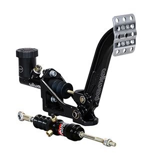

Another idea is to use one of these Wilwood floor mounted clutch pedals but I'd think the clutch pedal operation would be more awkward than the shifter!
https://www.wilwood.com/pedals/Pedal...20Pedal%20Kits
